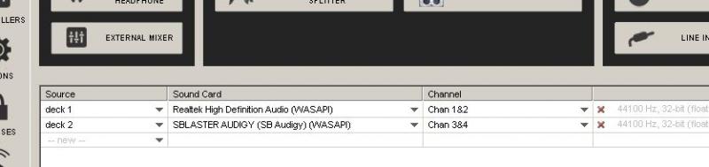

I'm using VDJ 8.1 on a Win7 Pro machine. I have the External Mixer license. I'm using TWO soundcards: (1) The on-board Real-Tek card, and (2) a classic SB Audigy card. Both sound card are functioning perfectly outside of VDJ. In my audio setup I've clicked on EXTERNAL MIXER and I set them to this...
I save the configuration, hit APPLY and the DECK 2 card (ch 3&4) never gives up any audio. VDJ is playing, I've got audio on meters on VDJ, but no card audio. If I flip the cards around in the config, and let the SB Audigy run deck 1 (ch 1&2), it plays fine... but then the RealTek card won't play for Deck 2 (ch 3&4).
I just KNOW I'm missing something simple, but I can't put my finger on it. Suggestions?
THANKS!

You said the audigy works fine in programs outside vdj, but playing stereo files outside of vdj would usually play them on channels 1&2.
Are you sure you have your decks connected to ch3&4 of the audigy (most likely the output labelled as 'rear speakers') ?
If not you should probably select ch1&2 of the audigy card as well.
Yup....

....and did you try switching to 1&2 and using those outputs instead (so both cards use channels1&2)?
You said yourself that 3&4 didn't work, whichever way you tried it - so try using 1&2. If you have two cards, there's no need to use 3&4 on either card.
