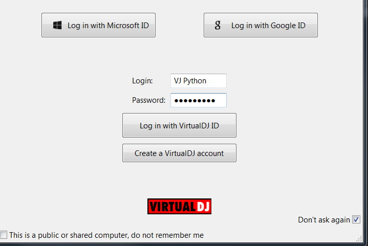

Perhaps 'don't remember me' is checked on the login screen?
Posted Sun 08 May 16 @ 2:26 pm
I got it for clicks
