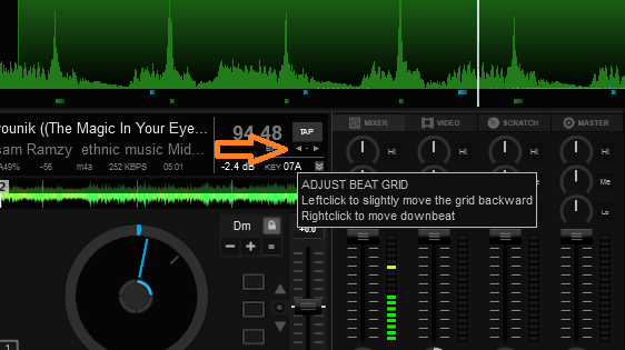

What is needed is for the pitchbend buttons to have a secondary function which moves the beatgrid. The sampler follows the beatgrid. This should not be too difficult, but may be in the programming realm.

I'm only just starting to look at this..there is a script for adjusting the cbg by % which might be assigned to a button.
Adjusting the cbg by 5% seems ok or less?.
Maybe using both the shift function or whatever and the pitch bend buttons to activate the script?
I've just tried this script using the keyboard and it seem to work.

That will be the same cgb script activated in the skin.
We can put it where we like.

Pitch-bend only moves two beat-matched, but out of phase audio waves into sync.
Moving the cgb, which dictates the sampler behavior can sync the sampler to an audio track.
Job done?
