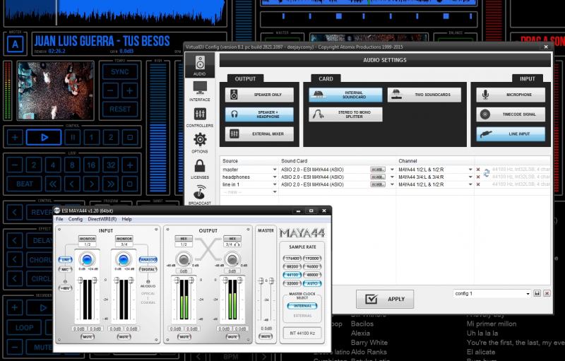

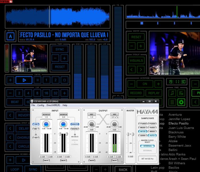

I have switched to VDJ8 and am in the process of adapting my custom skin to the new software. I was trying out the VDJ7 sound effects, to see which of them work on VDJ8, and while testing the LOOPOUT effect, the sound got destorted and died. Now, I can't hear anything anymore. Even after rebooting the PC. VDJ shows the level output, the ESI Maya44 PCI software shows the output, but no sound comes out of the speakers. I've tried the speakers with another source, and they work fine.
Anyone any idea? (Apart from "silence is golden, and such...)
P.S. I've configured the sound as ASIO 2.0, my soundcard is internal (ESI Maya44 PCI), I'm on Windows 7 64bit, and using the latest release of VDJ 8.

switching to another audio device (e.g. the internal) in the VDJ audio preferences and then switching back to the Maya, then hit apply. This worked for me once.

@ Sound&Silence: You had me hoping there for a moment, but switching didn't do it for me... No sound over the Maya :(

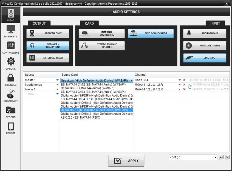

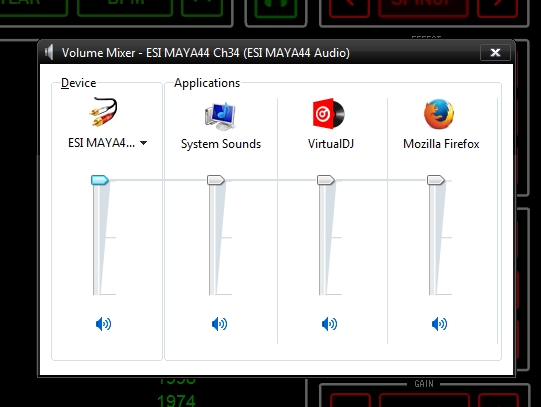

Did you try WASAPI instead of ASIO for the maya?
Also, try right-clicking the sound icon in the system tray and select 'open volume mixer' while vdj is open. See if perhaps the volume of virtualdj is down by any chance.
Posted Wed 20 Jan 16 @ 10:44 am
I tried WASAPI before, and tried it again now. No sound either. Noticed a strange thing, though: WASAPI does not pass the headphones sound (no visual level output in the ESI Maya44 software), only the master. When switching back to ASIO, both channels give visual level output (but no sound)...

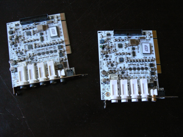

For some odd reason i never threw away the other ESI Maya44 PCI card, and I decided to try and put it in to see if it also magically worked again... and YES, it's working! So, it was never dead either. Now I have two soundcards that work, but that I don't trust (for live performances)!
So I'm thinking about buying the "M-Audio Delta 44", since it seems to be the most recommended sound card on the VDJ forums.
I'm still baffled about that no-sound problem, though. It cannot be the computer, since this is a different one then I used before, with the first Maya44 card...
