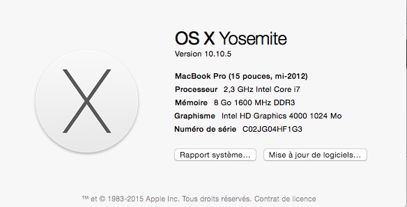

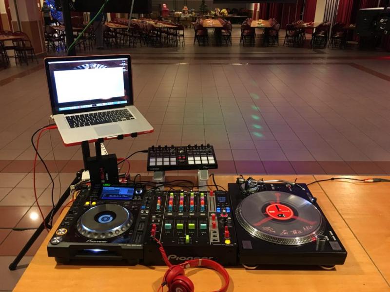

I've mix in a party last night and it was a nightmare. At home everything seems to be good. When i was at the party, It was so hard to beatmatch songs, there were jump in tracks and pitch was not steady.
I've Started with V2483 then after i install V8.1 2587 but the problem was still there.
here is my config :
Here is my last night setup :
I can't find where the problem come from
I am realy fed up, I seriously start to think about the reliability of VDJ.......
here is my config :

You need to describe your issues and your setup better in order to be able to help you.
I assume you're using timecodes. What settings do you use for timecodes ? Smart, Absolut, Relative ?
Also the CDJ in your pic, is it used with timecode or as a controller ?
What's your autobpmmatch setting ?
Have you checked your TT for proper placing and vibrations absorvance ?
If your system work fine for you at home but it didn't work right at your gig try to think what was different, what you may have done different or what setting you may have altered.
This info will help us help you further and solve your issues no matter if they are user related or software related.
Posted Mon 21 Dec 15 @ 11:16 am

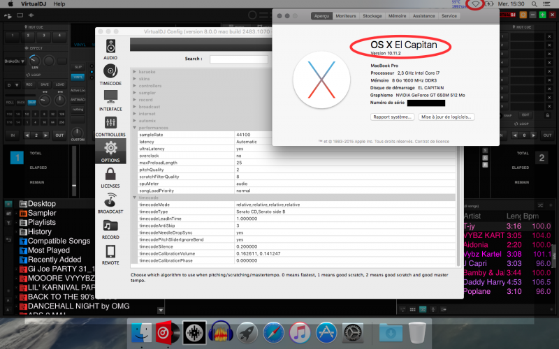

Yesterday i've made a first part of my test under the El Captain partition. I've played music for about 1h in the morning and everything was ok. That was sweet music, with Bpm Between 86-90 so no scratch.
Here was my settings (if someone can tell me if the settings is good for mixing with timecode) :
How you can see the wifi Connection was turned off.
After that , in the evening i decide to play some tracks with BPM between 105-110 with some scratch. Everythings was Ok at the beginning and after that some jumps and bpm variation appeared.
I mostly play video, the set was with some MP3 files and MP4 files.
I can not determine if these jumps and bpm variation is because the SL4 box is not officially supported with El Captain or if it's a bad setting ????
Today i'm gonna use the same songs and do it under the Clean install of Yosemite .
Posted Wed 23 Dec 15 @ 2:55 pm

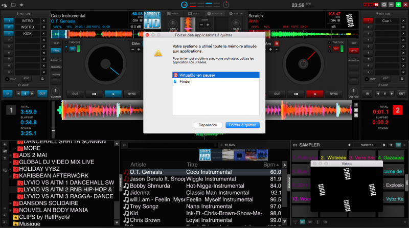

So Tonight i was training a little bit scratching on my Yosemite Session and surprise after about 20-25 mn something strange happened,
the waveform was jerky when i was using my TT. As soon i was released it was fluid. and after that VDJ stopped working :
i checked my Skin setting it was on 40 fps

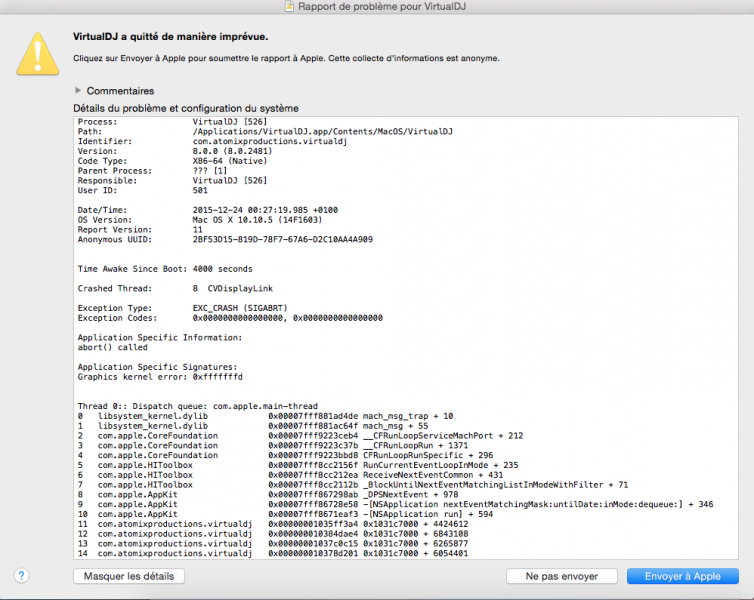

I restart the application, and after a few minutes same thing VDJ stopped :
for those who would like , I recorded in a TXT file the error report.
Posted Thu 24 Dec 15 @ 12:17 am

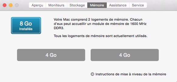

To put the odds on my side and improve the performance of my mac I will install 2x8 GB of memory and a 500GB SSD hard drive.
I cross my fingers.
Following the Adion advice, Tonight I installed the latest version of 8.1 vdj 2587 on my El captain partition .
I started with a small scratch routine for about twenty minutes with the TT and CDJ in timecode .
After that, i use the CDJ right deck and for the left deck I used the internal mode.
I have play for more than two hours without jumps and with steady bpm. just a few jerks with the waveforme with the fruit skin but nothing too bad I think.
it was a real pleasure because it was a long time that I had not experienced that. I will be carreful and knock on wood because I have a gig on Thursday but if it stays like this i will be able to sleep peacefully :-) . after months of struggling I will be able to finally have a normal use of VDJ and then focus only on doing my playlist. Whatever currently we are not yet there.

Hi everybody
Tonight i have made an other test with my Clean Yosemite partition and v2483 . Everything was ok, no jumps, no bpm variation.
i have played for about 1H30 and it was ok. Cross the fingers foe tomorrow ;-)
Posted Wed 30 Dec 15 @ 9:23 pm
