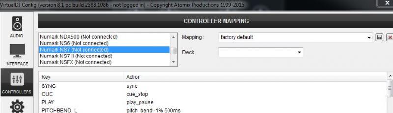

Try resetting your mapping in version 8 to factory default in case something has gone wrong there.

So used it last night,adjusted the latency and flawless great job vdj team
