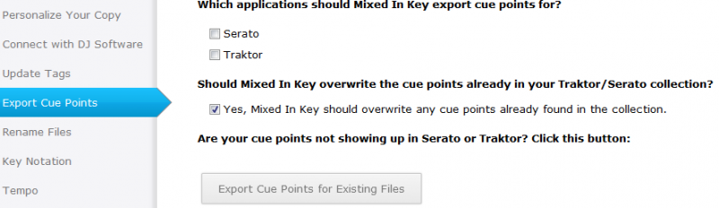

Mixed in key 7 after analyzing files and open in VDJ 8 no cue points is shown in the song in VDJ 8.
Although 8 cue points shows up MIK display viewer.
Any idea anyone? I check the appropriate box.
Posted Sun 22 May 16 @ 2:32 am
"export cues for existing files" has been clicked .. still no cue point..
Posted Sun 22 May 16 @ 2:40 am
You've not chosen the application by ticking the box. You need to select Serato (VDJ doesn't read Traktor cues AFAIK).

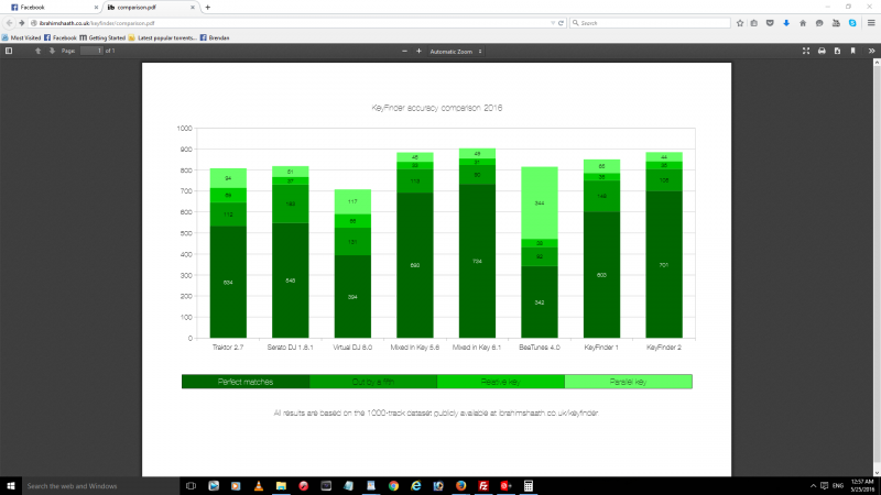

I found this chart on keyfinders site:
Posted Wed 25 May 16 @ 12:03 am
I can't read anything on this image.
Why don't you just post the link to the chart instead of making a screenshot and embed the image?
Posted Wed 25 May 16 @ 1:33 pm
Here's the Keyfinder Comparison Chart showing VDJ8 as having the least accurate key detection algorithm.
Posted Wed 25 May 16 @ 1:54 pm

If you want an accurate key detection using vdj8 you must use the correct mode to suite your music. One mode is for electronic dance type music with a regular beat, the other is for a broad range of music types. It is unlikely those who tested vdj8 had any idea how it works.
Posted Wed 25 May 16 @ 8:27 pm
