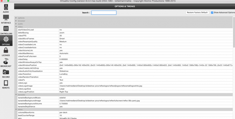

I've taken some screenshots.....

Right. What's my options here as not being able to play the bulk of my videos that are mpeg2 is unusable. What would be the outcome of deleting the settings.xml as first suggested or am I better doing a complete reload of vdj8?
Posted Fri 18 Sep 15 @ 12:54 pm
Deleting (or better yet renaming) settings.xml equals to a FULL reset of the software. Like if it was never installed on your system. So, there's no need to instal anything on top, or uninstal/reinstal.
Posted Fri 18 Sep 15 @ 1:05 pm

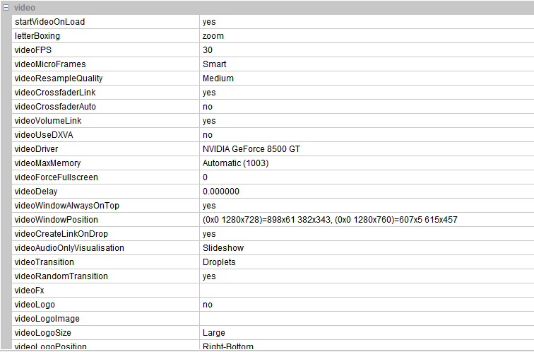

Compare your settings to mine and see if there is any improvement.
