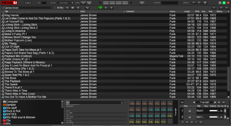

This is the part I'm talking about...
In the "browser_zoom" panel, he uses <fileview> in a panel to display just the centre part of the standard browser, and the other elements (folders, info, sampler, sideview) in further separate panels.
<panel id="filelist" visible="true">
<size width="1901" height="806-12"/>
<pos x="10" y="46"/>
<background>
<size width="4" height="4"/>
<pos x="23" y="1043"/>
</background>
<fileview>
<size width="1899" height="806-12"/>
<pos x="+1" y="-2"/>
</fileview>
</panel>
End result:
![](/image/21665/169469/dansbrowser.png)
...but doing it like Dan has, the borders between those panels are fixed. You can't drag them left/right or up/down. Doing that requires the <split> code.

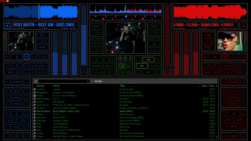

@Groovin':
check :(
@DJDAD:
Any insight on the (im)possibilty of changing the color of the search bar, text, and cursor with vdjscript?
This is what I've been able to achieve uptil now:
check :(
@DJDAD:
![](/image/32538/177802/1.jpg)

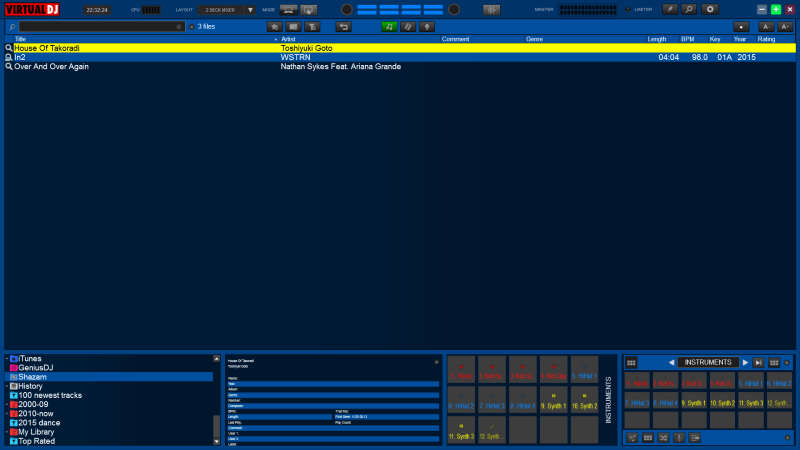

I just checked one of my earlier skin tweaks (original was Browser Zoom by djtouchdan - see pic earlier in this thread) and I have got a blue browser (including the search bar) using <fileview> so it should be possible.
![](/image/8368/177804/bluebrowser.png)
