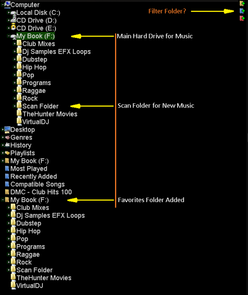

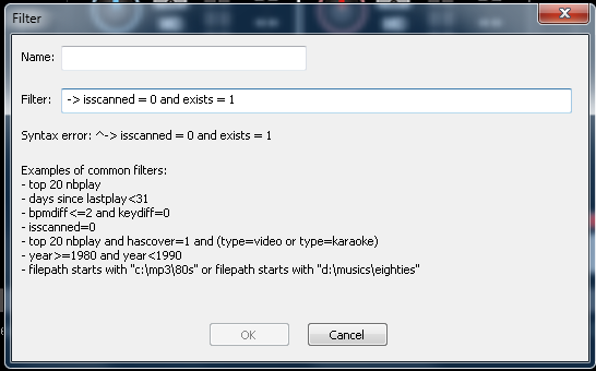

Gah, I had to reinstall VDJ7 after a reformat of my lappy, and re-encountering this same issue ... but for some reason the line code you gave me, I cant figure out how to get that working as you described here, and I could have sworn I was able to get it done last time :/. " -> isscanned = 0 and exists = 1" to filter folder right? Im getting this ...
While adding a filter folder for unscanned folders would be great right about now, and would still like to know how to implement this ... question becomes, if VDJ 7 isn't supposed to be starting off at the beginning, what is going wrong with A: the software, or B: how I'm performing the scan? Am I to scan favorite folders or the main directory for the hard drive itself? As I get new music, I have a "scan folder" ... scan A scan B scan C by artist an so forth ... for the new music to go into to separate the new un-scanned music from the music I already have on my hard drive, which is partially scanned for BPM's. BUT with a terabyte of music to scan, Id really rather not have to move every unscanned artist/album/song over to those retrospective folders in the scan folders to have them scanned separately ... especially if theres a much simpler easier an faster way :D.
This is what I see on my end ...
I don't really know how to explain this any better with out writing a novel, tried to keep it short lol. Anyways, any help is much appreciated :D :D :D
. While adding a filter folder for unscanned folders would be great right about now, and would still like to know how to implement this ... question becomes, if VDJ 7 isn't supposed to be starting off at the beginning, what is going wrong with A: the software, or B: how I'm performing the scan? Am I to scan favorite folders or the main directory for the hard drive itself? As I get new music, I have a "scan folder" ... scan A scan B scan C by artist an so forth ... for the new music to go into to separate the new un-scanned music from the music I already have on my hard drive, which is partially scanned for BPM's. BUT with a terabyte of music to scan, Id really rather not have to move every unscanned artist/album/song over to those retrospective folders in the scan folders to have them scanned separately ... especially if theres a much simpler easier an faster way :D.

The action is correct, just remove the ->
Now do a right-click on your hard drive that contains your music.
Choose “add to search DB“ from the menu.
After that, your filter folder should list all tracks that are not scanned yet.
