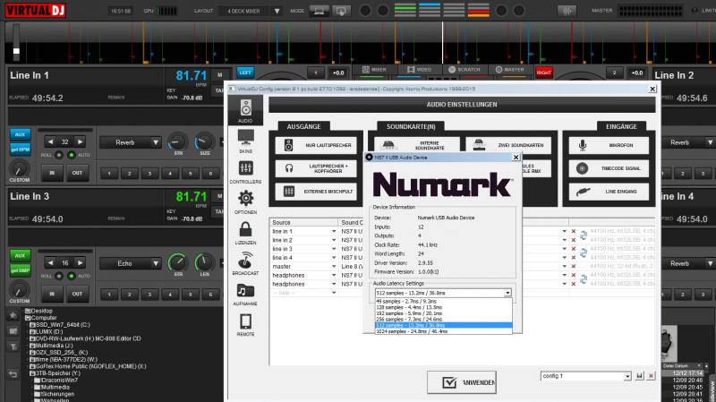

i have the same issue for a longer while and tried many changes in the settings.
I mix with external vinyl decks, which are connected to the input of the NS7.
At beginning of a session all is fine, but after a while ... depending on the setting (half hour ... one hour), it began at first with light crackling which be louder and louder.
While that happen i open the Audio Settings, and klick on ASIO and change the Audio latency to another value.
The sound stop short, when i accept the new value by klicking EXIT. And then it runs fine for a while again. But then the same crackling come back and becomes louder and louder. So i change the Audio Latency value in the Audio Settings again and again after the crackling comes, until i have sometime all values activated. And then on each Latency value is the crackling on the go.
And then comes a Breakpoint - and i doesnt know what it causes ... the crackling gone away suddenly, BUT instead the Problem with the crackling there is now a new Problem with the Latency. Between the Vinyl and the Output of the Sound in the Headphones there is a Difference of one or two Seconds! :) :) In this state i be able to mix 7,8 or nine hours without any crackling, but with the latency of one or two seconds :) :)
