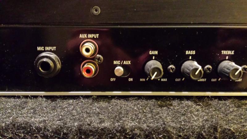

mic isnt working on the ns7 using v7 any ideas assumned it would didny check now i need it

          plugged in mic and nothing coming out.levels are up but nothing
    Posted Sat 13 Jun 15 @ 6:45 pm
           On your skin click "Master" then click "ON" for the mic. Then go to your mic/aux on the front of the NS7 and turn that on.

           I just fired up 7.4.1 with the NS7 and the mic works just by turning it on and I haven't used 7 in years.

           Is your sound card configuration correct in VDJ? And yes, you should've installed Numarks drivers for your NS7.
    Posted Sat 13 Jun 15 @ 8:17 pm
          did install the drivers .great sound from front of the house and monitor
    Posted Sat 13 Jun 15 @ 8:26 pm
          Can't recall if the Microphone Input is a Hardware or a software (sound card ) one. Did you try to add the Microphone to the Sound Setup and turn it on from the skin ?
    Posted Sun 14 Jun 15 @ 2:15 pm
          I did still nothing wonder if it it's an issue with the unit
