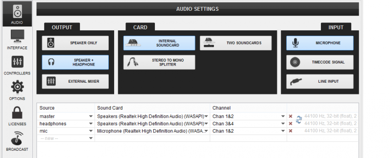

Its pretty much the same procedure as described here... https://virtualdj.com/wiki/EffectsOnMic.html
1. Add Microphone (mic) line to your audio configuration.
Example.
2. Use a spare deck to route microphone. You will probably need a 4 (or more) decks skin and a button (custom or keyboard) assigned as ..
deck x linein 'mic'
where x is the deck you wish to "sacrifice" for your Mic input.
3. Enable the Mic Input using that button and choose whatever Effects you wish to apply on the Mic Deck.
