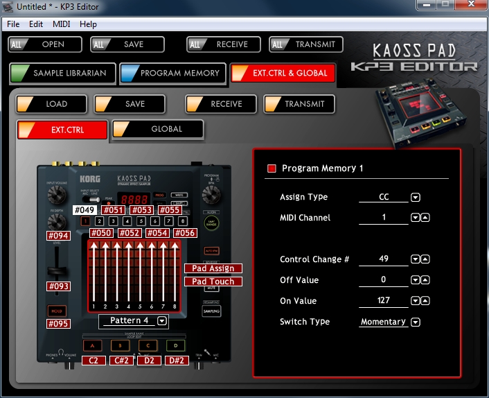

To use this mapper copy the files Korg Kaoss Pad KP3 definition.xml & Korg Kaoss Pad KP3 mapping.xml into Documents\VirtualDJ\Devices
load the file KP3 Editor VDJ8.kpg with the Korg KP3 Editor and transmit it to the KP3

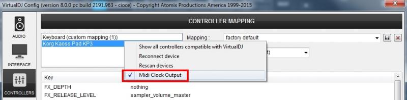

If you want to have effects in sync enable the Midi Clock Output like in this picture:
![](/image/7099/160591/aaa.jpg)
![](/image/4157/160590/KP3 midi setup VDJ8 (SHIFT+8).jpg)

To use the KP3 with VDJ 8 just plug the USB in the back of the unit to the computer, MIDI-USB interface is not necessary, and remember to load the file KP3 Editor VDJ8.kpg (it's inside the .ZIP) with the Korg KP3 Editor and transmit it to the KP3

Too bad! I have the KP3+ and not the KP3...
I tried to change the file from .KPG to .KPA as requetsed by KP3+ editor, then I get an error message "File does not contain enough data"
Do you think you can advice?
EDIT: Was trying to open the file in the wrong location of the program. Now it seems to open properly :)
I can see the KP3+ in the mapping, but it says: KP3+ 1 PAD (custom mapping) instead of in your example "Korg Kaoss Pad KP3"
Do I need to rename the definition files to match KP3+ ?
