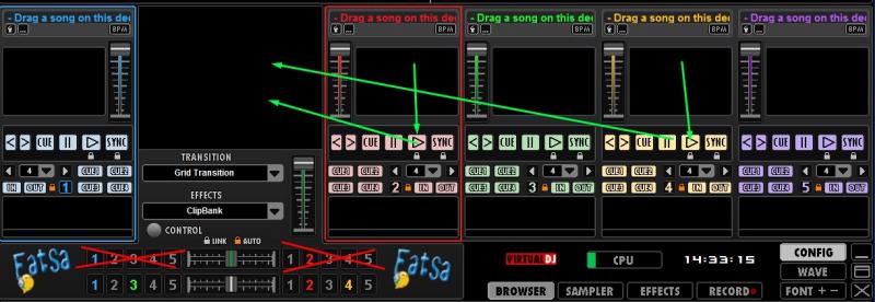

@ PhantomDeejay I would like the ability to 'Play on Take' WITHOUT having to allocate a player number. I would like to not use the allocated (play) boxes I have crossed out in Red. In other words to be able to just play directly. If Deck 1 is playing (left) & the next deck I want to play is 5, I want to just play it without having to allocate box 5. Thank you. Please if it's not clear let me know & I'll try to do a better diagram.

@ jmf28 Thank you but I'm trying to NOT do what you're saying. I do not want to 'select' a deck. I just want to play ANY deck at ANY time. Even if I play all 5 at once - I use my skin for an entirely different reason and sometimes when I forget to 'select' I click PLAY and that deck does not go LIVE. It plays, but it does not show on the main screen. Thanks & please get back to me if it's still not understood.

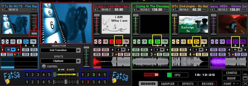

@DJDad, Hi and thank you for your response. I will try to explain using a Picture that hopefully will upload here. The Skin I have is made for me therefore I do not have a particular code to it. I have 5 Decks.
The 1st (far left) is always on, looped & with the SOUND-fader down. Reason: I use that & other images as Backround just like TV stations use a background (chroma key) for their presenters. The Video Fader is to the LEFT.
On Deck 2 I have a Jingle (video) which lasts for 3 SECONDS! I CLICK PLAY & IF I HAVE #2 Allocated it will go LIVE & the Video fader will move to the RIGHT (YELLOW ARROW)
On Deck 3 I have a SONG (Video) & I click that to PLAY & go LIVE as soon as the 3second Jingle ends. It plays, but because I have NO time to allocate Deck 3 (boxes in Purple) it does NOT go LIVE!
The Same as in #4 & #5.
What I need is for my RIGHT DECKS to be FREE from this "ALLOCATION" boxes (that's why I crossed them out in my 1st Pic) You are right there in your assumption.
So, unfortunately I'm a bit different in the way I use VDJ..... Nothing wrong in that I hope, but, technically I am absolutely USELESS and do not comprehend how to do or get what I need.
Simply, Deck 1 is my ALWAYS on MUTE Deck with the ability to create a great visual when I push the fader up a little and the remaining 4 Decks are my Players with the VIDEO FADER (Yellow Arrow) going Left To Right depending what's on. I just need to click PLAY & GO LIVE without assigning a deck.
Any more understanding now that I explained how I work? I'm willing to do a little video & send it to you guys. I'm sure in the future others may want to do this. My skin size is 1225x1080

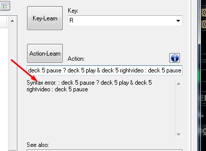

Good Morning DJDad - I tried but it didn't work - mind you I could have done it wrong. I copied each line then went to mapper>clicked on + add New Key>entered the key (Q) >paste the instruction & it said Syntax error, which I don't know what it means, but I did them all. I am willing to offer a "share Desktop" if there is a possibility for you to diagnose my problem better.
Posted Sun 22 Mar 15 @ 2:51 am
@kimbotec
Looks like you started the script with ":" which is the problem, try the above scripts
djdad wrote :
Can you try to assign 4 Keyboard keys (any of them) as ..
deck 2 pause ? deck 2 play & deck 2 rightvideo : deck 2 pause
deck 3 pause ? deck 3 play & deck 3 rightvideo : deck 3 pause
deck 4 pause ? deck 4 play & deck 4 rightvideo : deck 4 pause
deck 5 pause ? deck 5 play & deck 5 rightvideo : deck 5 pause
Posted Sun 22 Mar 15 @ 3:21 am
