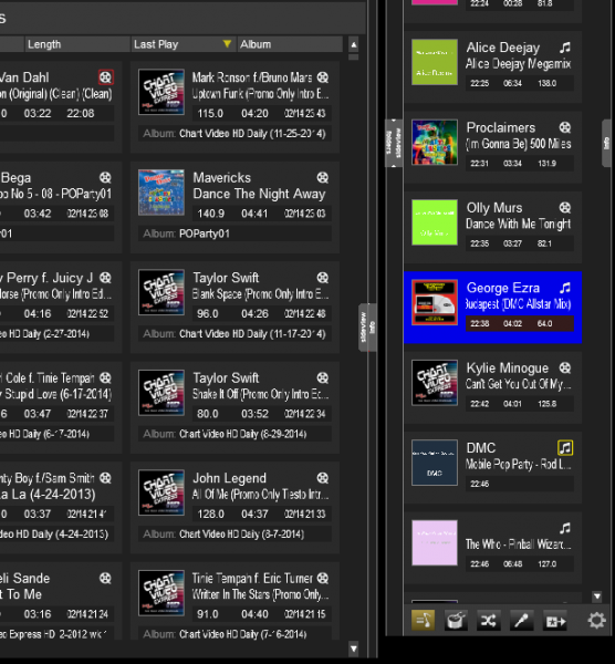

im toying with an idea for a skin that looks like this..
Its basically 2 browsers shown on same screen with main browser on left and the sidelist on the right (shown from top to bottom of screen)
where im going wrong:
as i drag icons from the bottom of the sidelist, it opens the INFO pane nad the original SIDELIST pane..
How to i lock out sidelist and info (and folders too in the 2nd browser?)
