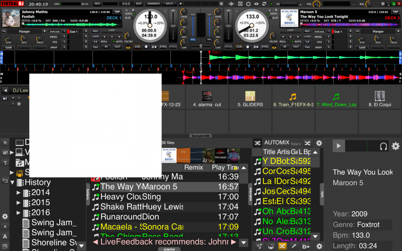

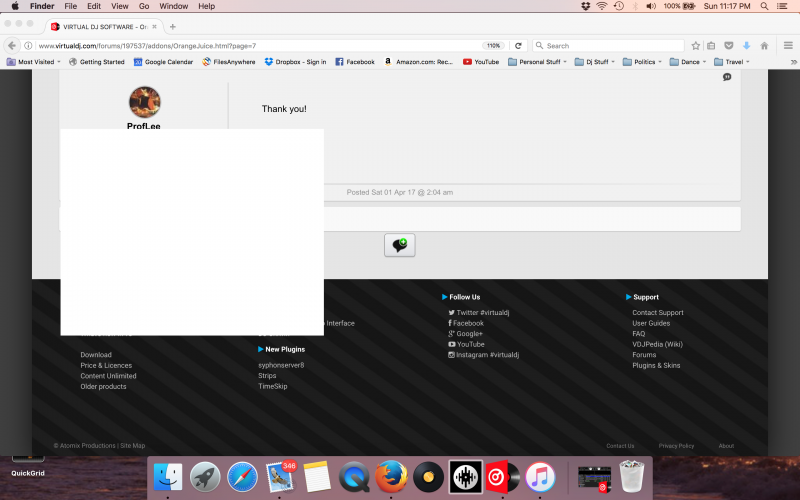

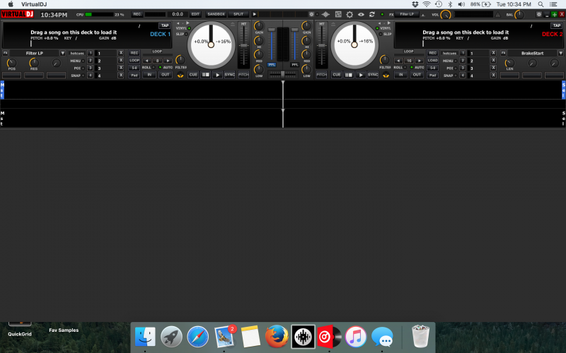

This just happened yesterday with the current version of Orange Juice. I've been using this skin without problems since the latest update was released.
Scenario: I was going to record my VDJ8 screen so I minimized the VDJ screen to get to my screen recorder and when I did, the entire lower half of the screen disappeared, as you see in the picture.
The white box in the middle of the screen has always been residing on the desktop whenever I opened Orange jouce but this time it went front and center to the skin. I thought perhaps others experienced this too and an update to either the skin or VDJ8 would correct the white box but no software update did so I figured the issue was skin specific and waited for a fix.

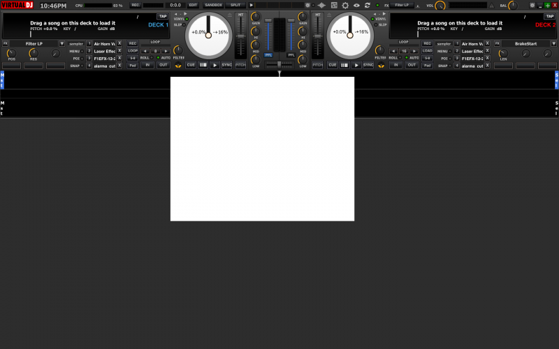

Posted Wed 04 Jan 17 @ 5:35 pm
2nd view
3rd view
Posted Wed 04 Jan 17 @ 5:36 pm

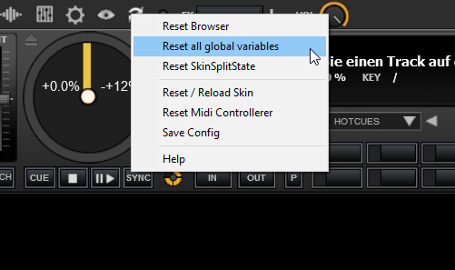

seems, there is an unsupported player/wave combination....
try fix 1: factory skin settings
or try fix 2 :reset all global variable

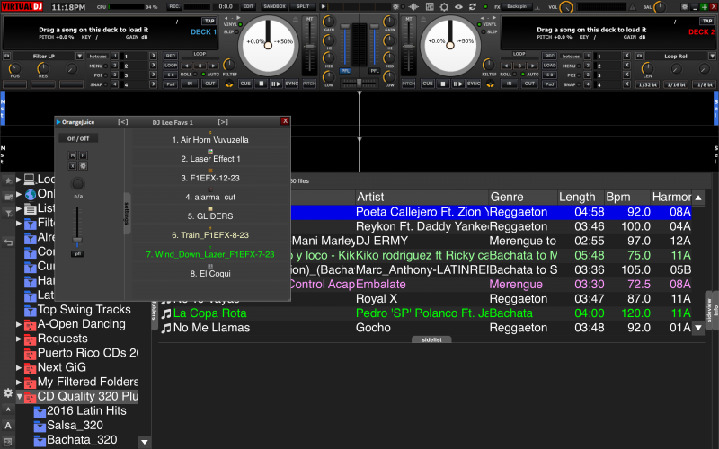

I've tried both suggestions but the white square still stays open. If I click anywhere on the skin, the square stays open on my desktop until I close VDJ..
When I click on:
Split Panel : Sampler
I can force the square to reappear as you see in the picture.
When I click on:

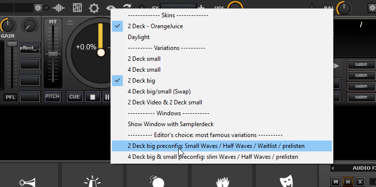

So the issue seems to be with the option:
"Show Window With Sampler Deck"
See video #1 of 2
See video #1 of 2

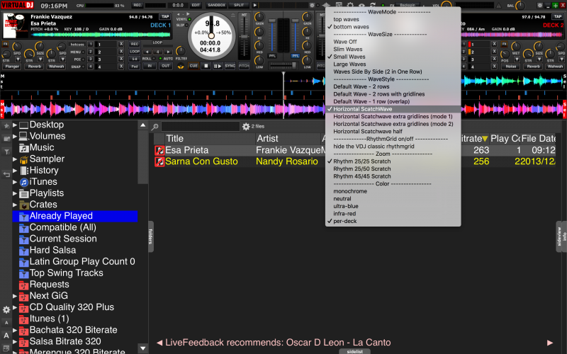

I noticed that unless you have the Wave Form setting set to Horizontal Scratch, you can't heard the audio sound of the wave form when manipulating with the mouse. The Horizontal Scratch Wave with Extra Grid Lines don't allow a scratch sound. Using MacBook Pro with Retina Display
i think this happens, because i reduce some mouse-active-zones to prevent a async waveform<>grid. Maybe i could change the layerorder to fix this....

fixed in version 3.6. Watch for aproval by atomix in a few days

Sorry it took me so long to report back after your April 2017 update. As you can see from the pictures, the Sampler pane still shows even after updating the skin.
Is there something i need to remove in setting so that the 3.6 skin can stick?
Posted Mon 01 May 17 @ 3:26 am

sorry, but this seems to be a VDJ bug.
try reset skinsplitstate and global variavbles
Try to report this direct to atomix
