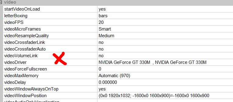

Okey thanks, how do I set the "VideoVolumeLink" any tips and tricks on it ?
Posted Mon 12 Jan 15 @ 11:31 am
Please have a look in Settings/ (advanced) options/ Video
If VideoVolumeLink is set to "yes" your Video Brightness is assinged to the volumefaders.
Aha, didnt know that !
