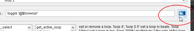

H entoli einai .. toggle '@browser'
Enas eukolos tropos na diavazoume tis entoles twn koumpiwn se ena skin (an auta exoun Tooltip kai den fainetai to action)..
Pas Config->Controllers tab.
Epilegeis as poume ton controller sou i to pliktolrogio.
Patas ena koumpi ston controllers sou i sto pliktorlogio.
patas to Key Learn (koumpi stin foto pio katw).
to Config eksafanizetai
me to pontiki patas to koumpi tou opoiou theleis na pareis tin entoli tou.
To config epanerxetai me tin entoli sto koumpi idia me auti tou skin.
Oson afora gia ton custom mapper. meta to mynima oti egkatastathike swsta, vlepeis to arxeio ston fakelo /Documents/VirtualDJ/Mappers ?
