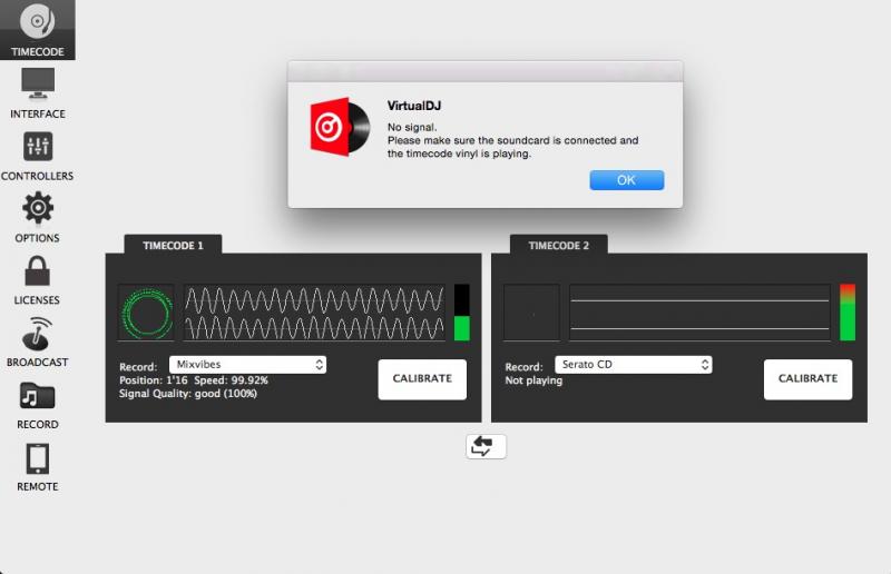

I'm trying to set it up but it doesnt work :-S, i can't calibrate timecode 2
Posted Fri 07 Nov 14 @ 3:43 pm
Post up a screenshot of your timecode window.
Posted Fri 07 Nov 14 @ 6:57 pm
I do not understand why the timecode 1 is ok but in Record: Mixvibes while it is a CD serato
and why it does not detect the timecode 2
I think I made the connection correctly by following the guide VDJ page 99
Posted Sat 08 Nov 14 @ 3:25 am

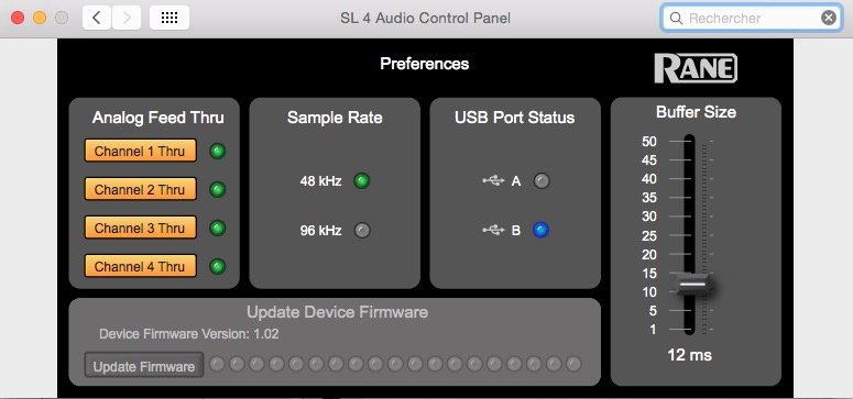

hmm , shouldnt the Channel Thru be Off ? Can you also try with the other Input Channels as well ?

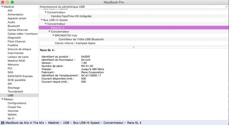

Btw, since we have you here, can you provide us the vid & pid values of the Rane SL4 ? You will find it in Applications->Utilities->System Information ->Hardware folder->USB sub-folder->Click on the Rane SL4 on the right side and post a screenshot if not sure which values we need.

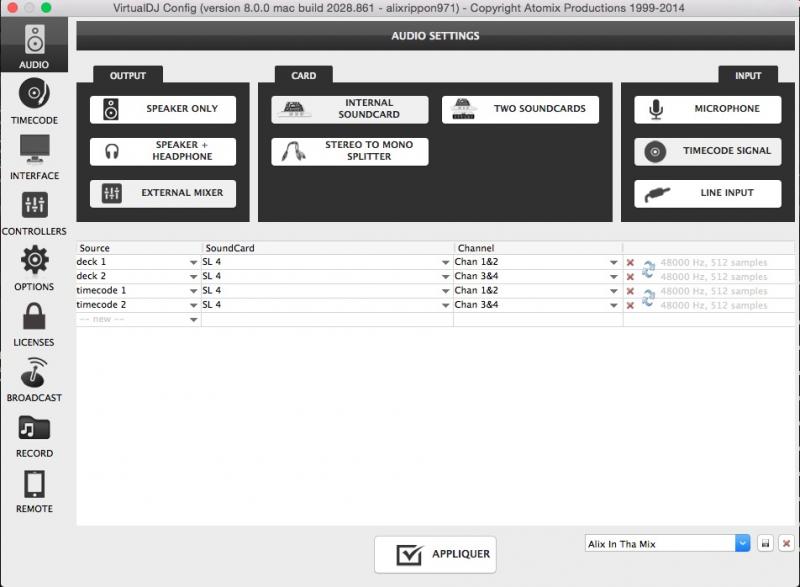

Ok i have turn off all the THRU channel , and use this config :
but still got only one deck recognize :-/
i think is that you ask me dad :

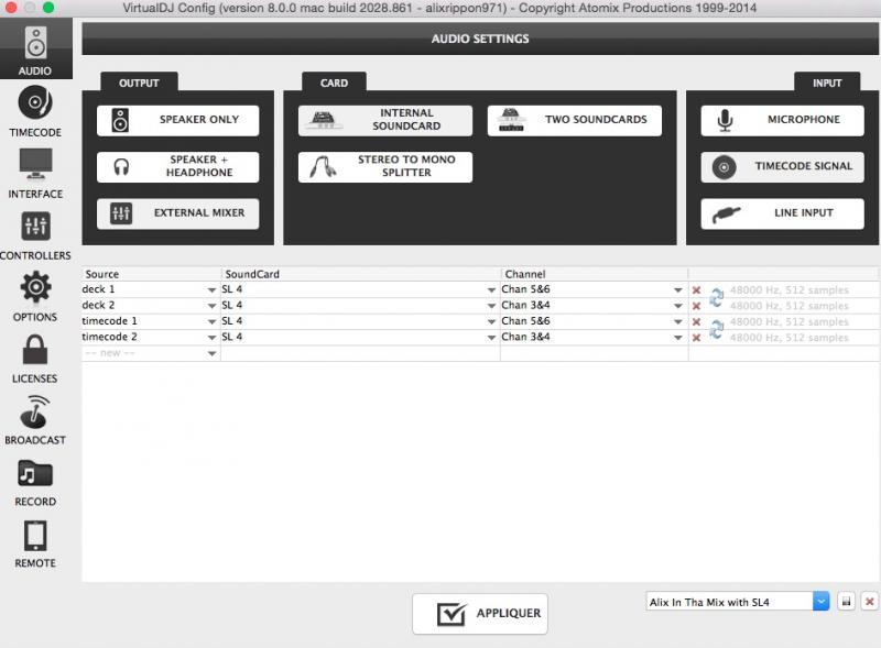

The diagram shows that you should use Outputs 3,4 and 5,6 and Inputs 3,4 and 5,6 as well, so you probably need to use those in the Audio config.
PS. I have just pushed an update which includes a pre-define audio configuration for the Rane SL4 (available in builds ending at .862 or higher). It should provide a button in the Audio Config with decks 1,2 to Outputs 3,4/5,6 and timecodes to Inputs 3,4/5,6, according to the recommended connection diagram.
Posted Sat 08 Nov 14 @ 6:58 am
Also make sure you've set the dip switches on the soundcard correctly for CD/Phono for each channel.
Posted Sat 08 Nov 14 @ 3:35 pm
Thx for all your good advice , after setting like this
the two timecode work well . You update will be welcome Dad, i waiting for it :-)
