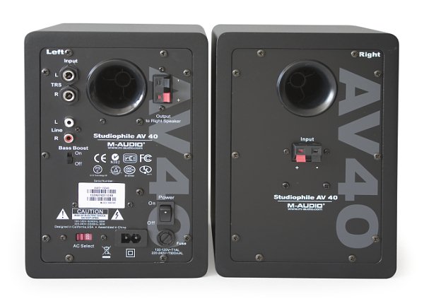

Depends on what your going for. Basically, any speaker/audio monitor with RCA inputs will do. I use M-Audio AV40 monitors to practice at home. Pretty affordable for the quality you're getting for beginners sounds set up. Very easy "hook up"

Hi guys thanks for your replies. I'm confused how to set up those speakers you've pictured. There are only 2 RCA inputs on the monitor, but 4 on the soundcard. How would I connect them to my soundcard?
Also, how do the two monitors connect together

If you are using a mixer, then the outputs from the DJIO, would go channel 1 and channel 2. If you are not using a mixer, output 1 would go to your speakers. Some monitor speakers have RCA inputs, if not then you would have to get adapter cables. Take a look at the video on the DJIO site here.
