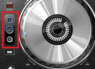

Isn't that what these buttons are for?

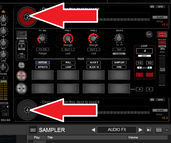

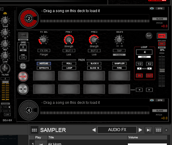

This is what my skin looks like:

rightclick on the number in center of each deck
