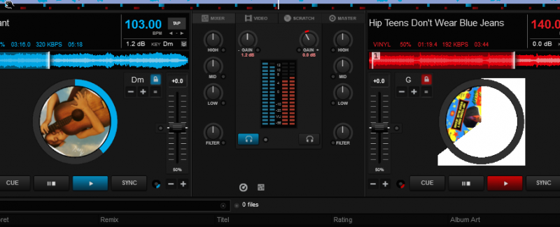

Hi...since the last two updates of VDJ the skin shows (the right deck) song position wrong:
![](/image/58422/161077/2015-04-11_19-17-15.png)
It will be adressed in next release.
For now, two workarounds :
- disable the wheel's songpos (menu deck / wheel / songpos)
- disable the cover on wheel option THEN restart VDJ (<-- restart required)
