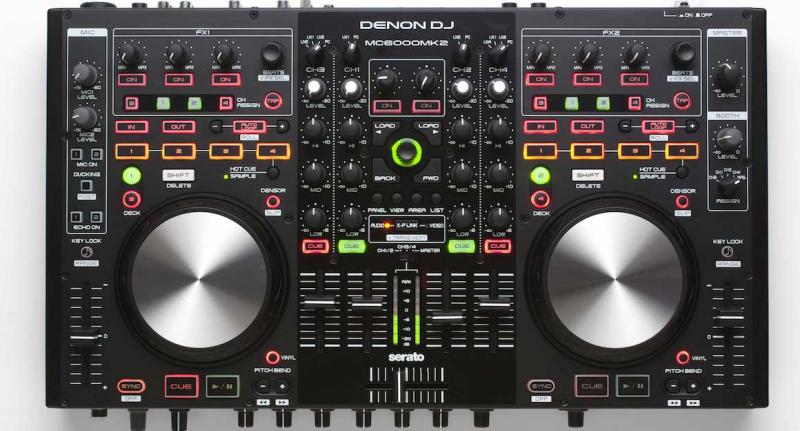

i tried this :
holding 300ms ? sidelist_add : browser_window "folders" ? var '$shift' ? browser_folder : browser_enter : browser_window "songs" ? var '$shift' ? var '@$v8bf_layout' 0 ? set '@$v8bf_layout' 9 & set '$fromdecks' 2 : var '@$v8bf_layout' 2 ? set '@$v8bf_layout' 9 & set '$fromdecks' 4 : var '@$v8bf_layout' 9 ? var_equal '$fromdecks' 2 ? set '$fromdecks' 0 & set '@$v8bf_layout' 0 & var_equal '$fromdecks' 4 ? set '$fromdecks' 0 & set '@$v8bf_layout' 2 : prelisten
and every second time i press SHIFT + track button it will activate prelisten. somwehere something is wrong here...

Which controller? I'm not sure what a "infinite push knob" is.
Posted Fri 08 Jul 16 @ 12:42 am
im using the denon mc6000 mk2
A filter knob stops somewhere or a eq knob for your highs, mids and base also stops somewhere and a volume knobs stop somewhere too. BUT
A infinite push knob means the knob can turn left or right without stopping (it has no end). its always 1 button on any controller. Its the knob that lets you scroll through your music. its not important here though. So far i have done this:
holding 300ms ? sidelist_add : browser_window "folders" ? var '$shift' ? browser_folder : browser_enter : browser_window "songs" ? var '@$v8bf_layout' 0 ? set '@$v8bf_layout' 9 & set '$fromdecks' 2 : var '@$v8bf_layout' 2 ? set '@$v8bf_layout' 9 & set '$fromdecks' 4 : var '@$v8bf_layout' 9 ? var_equal '$fromdecks' 2 ? set '$fromdecks' 0 & set '@$v8bf_layout' 0 & var_equal '$fromdecks' 4 ? set '$fromdecks' 0 & set '@$v8bf_layout' 2
What it does? It scrolls though the music and when on top of a folder if i press it, it will open the folder. If i press it again, i will go to browser mode (based on this skin). If keep it pushed for 300ms it will send the song in the sidelist tab. thats what it does so far. BUT i want to go to browser mode not by simply pressing it but by combining SHIFT + this button and when i simply press it, to activate prelisten.

I think that script is a little beyond me. However, it may work just as well or better on a different button. I gave up the functionality on my mc4000 for what happens when I press the button down and changed it to this.
Is there another button that would work for you? Maybe Shift+Panel button?
Posted Fri 08 Jul 16 @ 1:08 am
for now i kinda did something else. i totally deleted the prelisten function and put it on the view button. But my track button works perfect with your script!

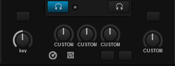

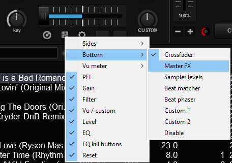

Do you think you could add "Crossfader Eq" or "Custom 3" below showing 3 horizontal faders?
(to be used for example with eq_crossfader_xxx)
Something like that
or
Something like that
or

Consider it done dear friend :)Do you think you could add "Crossfader Eq" or "Custom 3" below showing 3 horizontal faders?
Posted Wed 13 Jul 16 @ 7:19 pm
