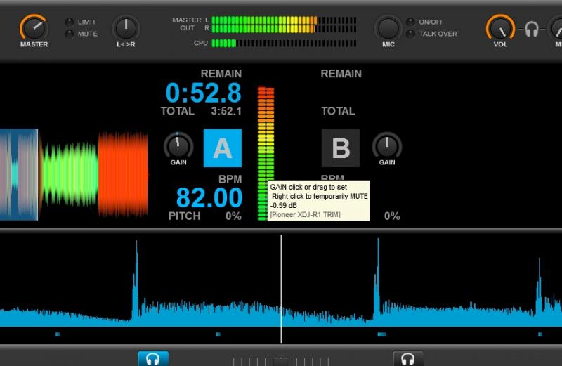

My problem is this... I have created an invisible vertical slider for gain adjustment and placed it over my channel VU meters. this way you can adjust the gain by clicking or dragging when over the VU graphic. This works really well, but the tooltip is never visible. The tooltip which always appears is the one for the VU ('get_level' %'etc).
I have now realised that the VU is snatching focus back when it redraws the level graphic and is suppressing the slider tooltip. I have verified this by moving the invisible slider and the tool tip works when it is not over the VU bit - it works as expected. So....
I need to suppress the VU VDJ generated tooltip and force it to show my slider tooltip instead.
OR
Somehow add my gain feature info to the VDJ VU tooltip.. hmmm :-/
EDIT: I will try your visual clickthrough trick!! ;-)

My code.. (graphically placed over VU meters of the same dimensions)
<group name="invisible_gain">
<slider action="gain" direction="up" orientation="vertical" rightclick="volume 0% while_pressed" tooltip="Set gain by click or drag">
<pos x="+0" y="+0"/>
<size width="30" height="230"/>
<off x="2100" y="1880"/>
<on x="2100" y="1880"/>
<!-- <tooltip>Click or drag to set GAIN</tooltip> -->
<fader>
<size width="30" height="1"/>
<pos x="2100" y="0"/>
</fader>
</slider>
<!-- <visual clickthrough="true" tooltip="Click or drag to set gain">
</visual> -->
</group>

Fruit: Once I disable the tooltips for the VU I get the gain value returned in a tooltip. The slider works correctly in all other respects.
Dan: <slider> is immediately after the VU code. All works perfectly if I position it elsewhere, it just doesn't like being on top of the VU. I have also disabled all tooltips for the VU using tooltip="", which does as it should, but the added tooltip text for slider is still absent. Stumped!
UPDATE: I tried my code on my PC in the club and it worked as it should.... :D I will need to retry on my home pc and see if it was just a syntax error somewhere?? To get it working I just added tooltip="" to the VU elements then the gain level showed, including my added text.
Thanks for all the help! :-)

all is ok now :D code used is below.
<slider action="gain" direction="up" orientation="vertical" rightclick="volume 0% while_pressed" tooltip="GAIN click or drag to set \n Right click to temporarily MUTE">
<fader>
</fader>
</slider>
</group>
Why this wasn't working before I don't know... I will investigate at home tomorrow and report back.
Posted Sat 27 Sep 14 @ 8:08 pm
