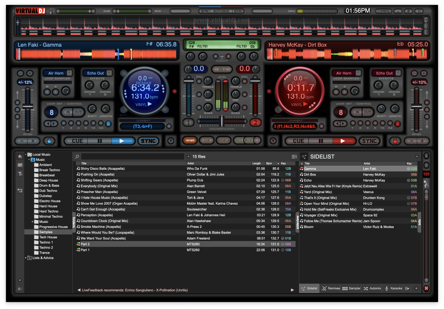

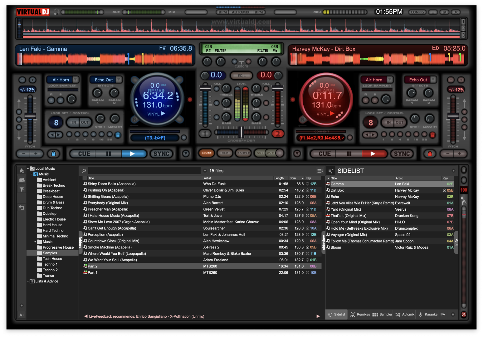

Just found this skin!...LOVE IT!!...its awesome!!..It looks amazing..and...it gives me the ability to see the time remaining in LARGE numbers...also, I don't have to look at all the rhythm waves which are so distracting for me when im looking at my computer screen. I had to use a little custom button for broadcasting cause I could't find one...but it works...:)
Well you have DJ Format to thank for that. He's the graphics wizz. There are many of his skins available here, but only for VDJ 7 and earlier.
He did return briefly a few months ago, showing what he was up to with VDJ 8 skins (which were new to him) - but he's gone again. See this thread.
Also this one.
Mix Lab is not really a suitable resolution for modern screens, and much of the skin functionality doesn't match with the capabilities of VDJ 8.
