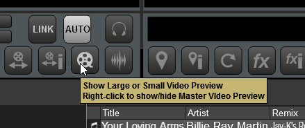

Okay, found the issue why the preview window doesn't show a video.
It is in the globalvariables setting and there is an entry " $videomas=0=1.0000".
If I change that to "$videomas=0=0.0000" it does work again.
But I have no clue what that setting means.
Posted Thu 01 Sep 16 @ 10:56 am
I cannot find $videomas=0 in settings and not in the skin xml
can you describe exactly where you found it or take a screenshot please?
Posted Thu 01 Sep 16 @ 4:36 pm
The variable hides the Master Video panel. Its the right-click option on the Video button
Posted Thu 01 Sep 16 @ 7:06 pm
Aha, never knew it has that option.
Posted Thu 01 Sep 16 @ 9:19 pm
$videomas=0=0.000 gets toggled in global variables when you right click the little video icon (to toggle show video in skin on off)
but I still cant work out how master video would end up being drawn in wrong position :(
Posted Fri 02 Sep 16 @ 12:32 am

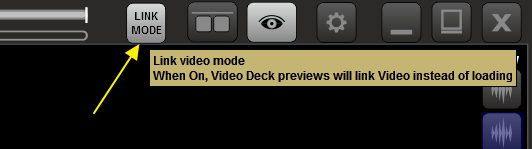

Since the update when opening VDJ the "link mode" is enabled could it appear off as before?
Posted Wed 17 May 17 @ 10:22 am
The LINK MODE button is simply handling the VideoCreateLinkonDrop and the selection is kept across sessions. Nothing is changed there.
Posted Wed 17 May 17 @ 11:45 am
@DJSoulman
Nothing is changed there either
The right-click action to the Video button is turning on/off the video output on the Master Video Preview on the skin (the center window). It does not turn video "engine" on/off.
You can assign a custom button as...
- video to turn on/off the Video engine ,
- video_output on or video_output off or video_output on ? video_output off : video_output on to turn on/off/toggle the Video Output (on your secondary screen and leave the Master Preview still on)
Posted Wed 17 May 17 @ 11:52 am

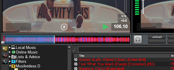

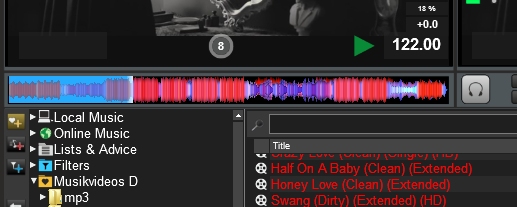

I found something curious.
First, it just happens with this action mapped to a button:
and experimentalSkinEngine = ON
As you can see, after loading a new track with the action, the wave of the previouse track does not get cleared.
Interessting fact: Doesn't happen with every new track loaded.
It does not happen with the default skin an experimentalSkinEngine on. So must be something skin related.
browser_window 'songs' ? browser_scroll +1 & deck 1 load & song_pos 25% & play : browser_scroll +1
Posted Wed 16 Aug 17 @ 5:50 pm

So I'm not the only one experiencing this. And it is not action related as it seems. Curiouse what it is.
EDIT:
Pls don't remove it.
At least a minimum amount of learning is reasonable.
EDIT:
Posted Wed 16 Aug 17 @ 7:43 pm
The experimental Skin Engine , well, its experimental lol
Meaning that there may be some bugs there.
The skin songpos is inside a panel so that could be a reason why not refreshed properly, since the one in the default skins is not.
So i would suggest not to use this option enabled with such skins.
Will report the bug in Dev Team.
Posted Wed 16 Aug 17 @ 9:44 pm
