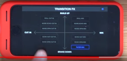

What about emulating the new DDJ-200 transition effects?
Starting at 12:12 here:
You can only listen to 4 now, but more will come, and some can probably be guessed based on the names:
It's really just combining effects we already have, so why not make those available for VDJ users as well no matter which controller they use
- maybe even select between them on a pad page :)
