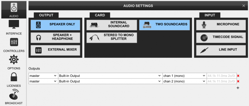

Please explain the setup for 2 decks to output in mono with one sound card (left channel and right channel with same mono output signal).
No matter what I try in the audio settings, it changes to something else.
I want the most simple setup possible, yet VDJ will not allow it.
Internal sound card - output to speaker only - MASTER - channels 1 & 2 (mono) <--- doesn't work
Also setting master to channels 1 (mono) and 2 (mono)
Internal sound card - output to speaker only - MASTER - channel 1 (mono)
Internal sound card - output to speaker only - MASTER - channel 2 (mono) <--- doesn't work
The result is either mono on left channel only (nothing out of right side), or it auto-selects a different sound card setup.
A single internal sound card has 2 channels - left and right. I need to output ALL audio signals to both channels (right and left) in MONO.
How is this accomplished?

If you're doing all that by using the "splitter" setting then that's undoubtedly why you're having issues.
The whole idea of a splitter is to send the master output to one stereo side, and the cue signal to the other. It's not for configuring one single mono output.

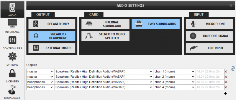

This outputs both decks in mono on both the left and right channels of my output device:
Tested and working fine, so if you're not getting that then it's likely something at a lower level is interfering. Worth making sure all enhancements are disabled on the output device in the operating system for example.
This isn't related to the plugin though, so you should probably start a topic in the relevant area if you haven't already :)
