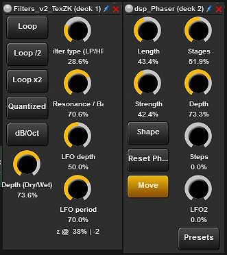

At the moment they're extremely bland and very small. The ability to resize has been removed prior to release, so the text often doesn't fit.
What's stuck in my memory is how they used to look...
I think the current FX GUI needs a makeover! We've got a little white popup box which doesn't match the rest of the sofware, and tiny grey edit boxes.
Compare and contrast. Which looks better?

So I must have misunderstood, it seems to be working for normal browsers, only !
Gave it a really quick try :
So far I believe that :
- button cannot be 'decked' (I guess slider either)
- it cannot have a background / titlebar
- if you use a pluginzone, you cannot dock plugin windows anymore
- text size cannot be changed (as you can see on 2nd pic it is clipping) or maybe by one or two px
- you cannot give a size to plugin windows
- you can force the pos where it must show, but the plugin window won't be movable anymore
- it is buggy
Buggy like, sometimes the same plugin will show 'skinned undocked' AND 'not skinned docked' at the same time. And other strange behaviors like crashes.
But that was just a quick try I'll look further.
- it is buggy
Posted Thu 31 Jul 14 @ 5:29 pm
