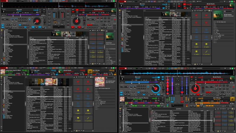

VIRTUALDJ 8 SWAP -4 DECKS
The default 4 decks skin in a swap decks version.
Download link : http://www.virtualdj.com/addons/16846/VirtualDJ_8_-_SWAP.html

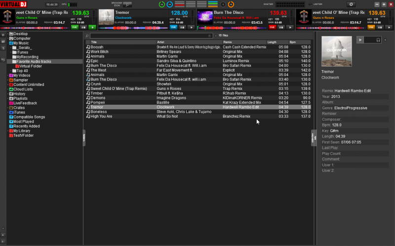

- Multi FX (3 slots) support
- Special Slicer panel
- Browser Zoom mode with Mini decks

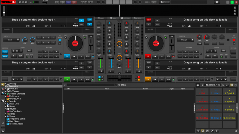

Major Update
VIRTUALDJ 8 SWAP version 2.0
Download link (and screenshots) : http://www.virtualdj.com/plugins/index.html?addonid=16846
Some useful actions/variables
toggle '@$decks' (toggles between 2 and 4 decks mode)
toggle '@$browser' (toggles between normal and minidecks with large browser)
cycle '@$center' 4 (cycles through the 4 center panels - use this instead of the skin_pannel actions to secure that the same Center panel will be disaplyed in both 2 and 4 decks mode)
- Added 2 Decks mode with mini decks (selectable from the top)
- Added Sandbox
- Remain time flash on end
- Added Waveform color menu
- Added Battery status
- New Center panels
- New Browser Icons
- New Song Positions Progress bars - menu on the top
- New Scratchwaves
