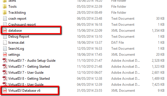

I figured since there is only one database file (documents/virtual dj/database) it automatically would migrate into 8.
So for now if I use 7 and want to try 8 I will just have to do the batch ad to DB.

You should have 2 database files.
V6 one is for V7 and before.
database.xml is for V8.

Nope it is not there.
I am going to do a new install and see if that works.
