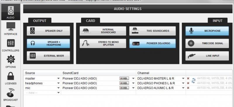

its working in windows 7 64 bit i have the audio configure like this image maybe it helps u :-)

ok i got it sorted my config got messed up somehow
should look this way

Does the Ergo get detected as 4out/2in in Audio Midi Setup (Applications->Utiltities) ?
Btw, the reason we have chosen LineIn instead of Mic for the single Inputs of the Ergo, is that we followed the default LE skin of the unit which offers AUX/REC button for each deck. So depending on which Input you need to use (LineIn or MIc switch from the back side of the unit), you can use the AUX button to route the Input (LineIn or Mic) to a deck and then to Master.

also, try looking on master panel in skin.. you have to have mic "Live" enabled.. i had same issue.. even though it's set in audio config, it does need to be made "Active"
hope it helps
hope it helps
