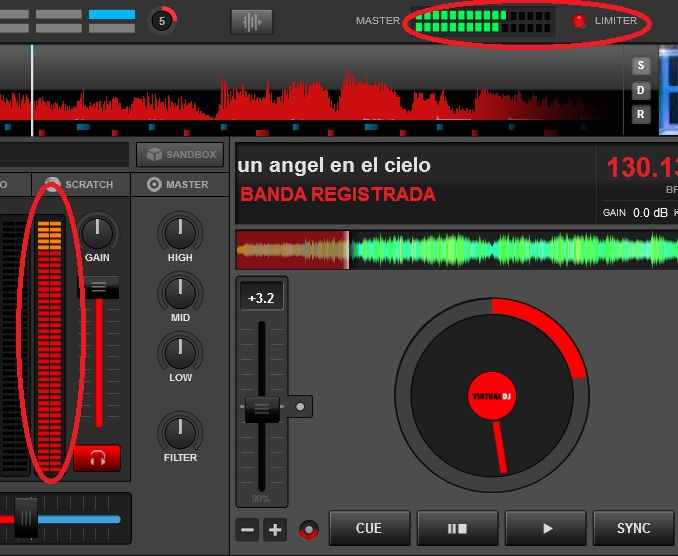

scrach work, saturates the master channel ...
.jpg)
Posted Mon 09 Jun 14 @ 5:54 am

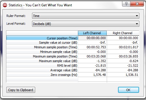

I too have to chime in as this is the only problem I am having with VDJ8 and there is definitely something amiss. I will use one track as example, Joe Jacksons "You Can't Get What You Want". When I view the statistics for the waveform of this track, I can see that the peak output is 0.624db.

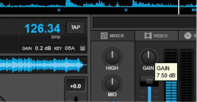

Then when loaded into VDJ8 and hovering over the gain knob, it indicates 7.50db while in the deck info window, it show 0.2db. The 0.2 factor makes sense to me but leaves no headroom at all.
I closely agree with homeworld above describing a "clamping" affect. I would describe it as suppression or attenuation that fluctuates too quickly making the output quality unacceptable. Now throw in doing any sort of EQ from your controller. When I turn up the bass even slightly, the fluctuating suppression goes berzerk and the limiter light flashes constantly.
A digital soundfile cannot go above 0db thus it would seem appropriate for a limiter algorithm to keep that in check and include EQ variations. Perhaps the auto-gain is processing waveforms too close to 0db not leaving enough headroom allowance. I have always liked the auto-gain in VDJ7, never altered the gain of a track and never used the limiter as my amps have a 1400mv input and my audio card maxes out at 900mv so hardware wise, I'm safe. And I have never seem the clip indicators on my amps even flicker.
IMO, if the limiter is to be a constant function, then the auto-gain algorithm needs reviewed.
