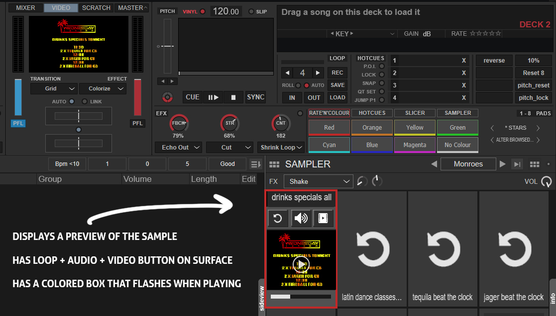

hi ,id like to make some suggestions about how the video samples are displayed in the sampler
please see image , thanks
basically to be able to mute the audio, or video, or loop the sample from the surface
and also to be able to preview the sample because currently you have to pretty much play the sample to see it...
