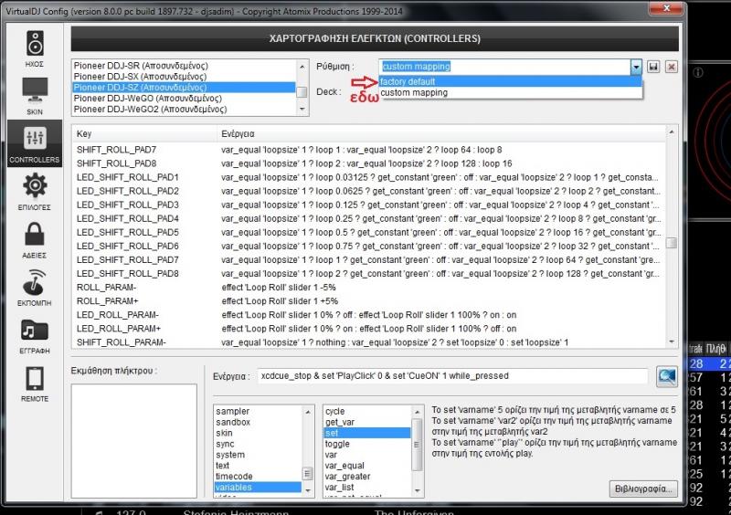

Oi mappers gia tin SZ enemerwthikan prosfata. Vevaiwsou oti trexeis tin teleutaia build. Logika tha prepei na einai 1878.732
Exoume prosthesei kai to kokkino ring, pou deixnei to loop_progress kathw kai ta ekswterika ledakia na anavosvinoun otan to tragoudi ftanei sto telos tou.
Vevaiwsou oti exeis epileksei to "factory default" apo tin lista mappings

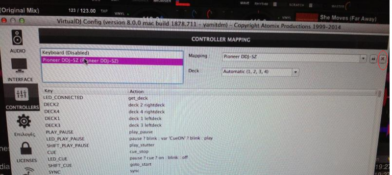

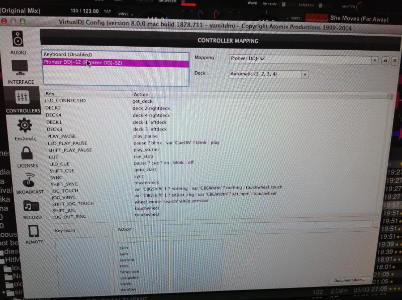

auto pou vlepw apo tin photo pio panw , einai oti o controller den exei anagnwristei apo tin version 8 me to default mapping. Dldl ousiastika anagnwristike san Simple MIDI kai epomenws protimise ton mapper tis version 7.
To pio pithano senario einai oti sto Audio Midi Setup i konsola exei parei allo onoma apo to kanoniko (px tin vlepei san USB Midi device)
Ti kaneis..
Anoigeis Applications-->Utilities-->audio Midi Setup.
Apo to panw - panw menu stin othoni sou, epilegeis Window-->show Midi Window
Ekei tha deis tin konsola me kapoio onoma (pou profanws einai lathos - symbainei syxna sto 10.9.3 kai panw )
Kane diplo klik kai onomase tin ... PIONEER DDJ-SZ
Meta anoikse to VirtuaLDJ 8 pali

Ανοιξα το audio midi setup και η ονομασία του ηταν DDJ-SZ. Την άλλαξα σε PIONEER DDJ-SZ αλλά τίποτα

pata to X gia na diagrapseis to palio mapper gia na dei to factory default
