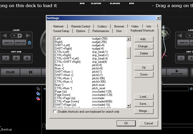

I don't know if you guys remember the "skip beat" feature in VDJ 5 but I would like to know if it's possible to do it in version 7 and if not is there a way to get the pro version of 5 from vdj? I have friend loves that feature for his chop n screw mixes...thanks in advance
p.s. I found a trial version of 5 but I would like the full version that I can use the serial with

it was listed under keyboard shortcuts as skip beat....

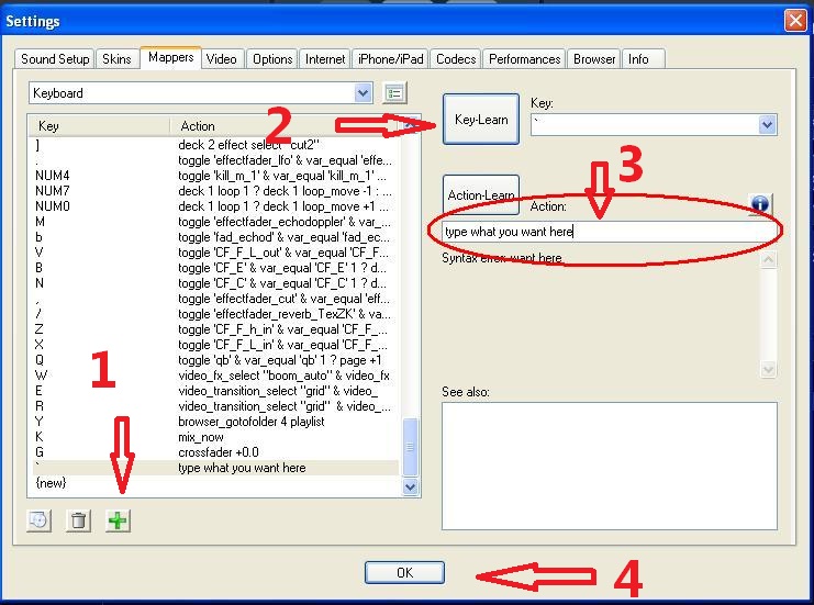

my question is how? since the newer version I haven't attempted to program any shortcuts. If you would be so kind as to explain how to do this it would be much appreciated.

Go to config -> mappers -> select keyboard mapper form the dropdown box -> press the little green + on the bottom left side of the window.
Press "key learn" button -> press the key you would like to map
Right next to the key learn button the name of your pressed key should now be displayed. e.g "B" or sth.
Right under this textfield is another, labeld "action"
Write this action into that field and then press "ok" or "apply" (not sure how the button on this window is labled)
Action:
+2 indicates to jump/ or skip 2 beats forward. -2 would be 2 beats backwards from the current position.
you could also use 0.125, 0.25, 0.5, 1, 2, 4, 8, 16, 32, 64 ...
Action:
goto +2
Posted Fri 04 Apr 14 @ 9:56 am

Thanks man.....and to everyone else that responded!
