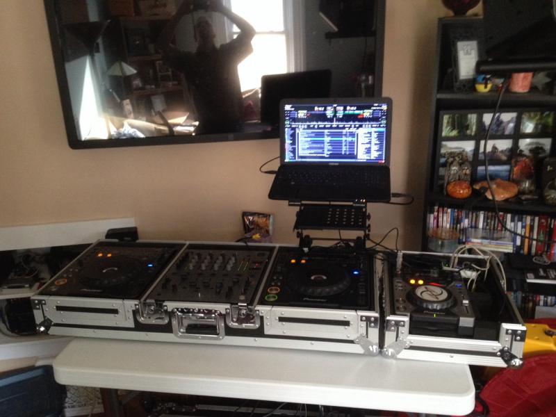

What a coincidence this topi just came up.
I just purchased a coffin case to go to my new to me DJM600 and CDJ1000\'s. I also purchased an Odyssey LstandM to use with the case.
The first thing I didn\'t like was all the power cables coming out of it. I had a few of the same power cables used on the CDJ\'s and my laptop, so I soldered them together to make an octopus of sorts. I still need to put a female receptacle on it for the DJM. The reason I did not splice the DJM in, or use the original cables, is to have a backup if there is a failure. Like someone pinching the cable end.
Less things to plug in and less cable in the coffin.
I am leery about using that connector only because if something happens to it in transport (even though it\'s recessed) or what ever, I would want another option. Havering the original cables would give me that option I guess. Or a female plug on the inside. Next will be some XLR jacks with short leads to the mixer.
I have a CDJ 400 that sits in a CDJ1000 case next to my coffin. This holds a USB3 hub, audio interfaces, etc. the power snake has a lead that hops over the side and feeds that stuff.
The LstandM shelf holds my wireless mic receiver.
The picture shows a layout of some of the stuff as I was starting the project. Let me know if I can provide more information. This was just a feasibility test, more improvements to come.

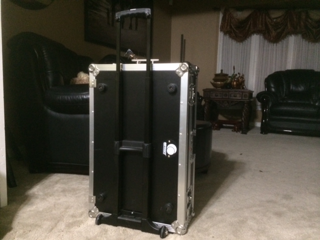

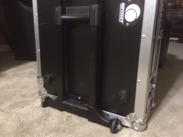

Just minor modification for easy transport... The Odyssey case is for my NS6.
Detachable Roller (My PA Mixer also has one)
I didn't get mine from here but they are similar and their price is lower.
Link: http://www.tchweb.com/tchstore/product/500-2306/c900/Three-Stage-removable-Surface-Mount-Extension-Handle-with-Wheels.html
If you\'ll take a closer look on top, I also added a handle on top (cabinet/cupboard handle from Home Depot).
