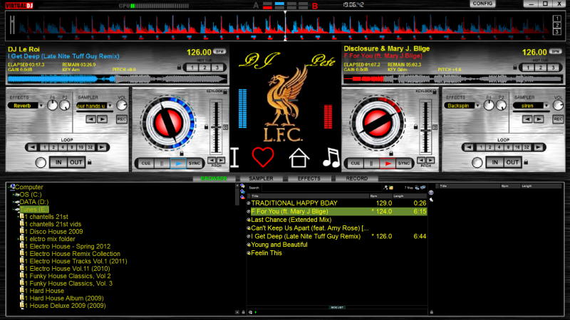

this is my skin that i changed

As synthet1c says you can take anything from an existing skin and put it into another skin you just need to understand the Skin development page, I didn't use the skinning program I just used M$Paint, I didn't do anything fancy I just made some extra buttons for effects, added some visual indicators for variables, added a VU meter for the Master output and ironed out some things I don't like about the default skin (like the way the waveform fades in and out) I also moved the filter dial on to the mixer and the key select and indicator to the bit of empty space just to the lower right of the deck.
Make copies of the skin you want to play with and just have a crack at it, when you get stuck, just ask and we'll help you out.

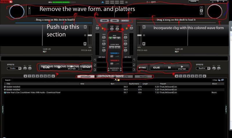

if you can see that...

that's a pretty big job. I would copy all the bit's you want to keep in photoshop. The way you would copy it is highlight with a select box and use ctrl + shift + c to copy. it will copy all layers, then create a new layer and make sure that's highlighted then use "paste in place" ctrl + shift + v to paste it at the same co-ordinates that you copied it. then lock the layer so you don't accidentally move it. Once you have copied all the elements you want to keep, unlock the layers and select all of the accept the background they you can change the y co-ordinates eg change it to something like -200px it will move all the elements by that amount. Make sure you record this number as you will need it to modify the XML.
Once you have done that you should create vectors with gradients to match, you can use the color picker to get the same effect.
Now the thing you may find the most difficult.. modifying the XML.. I recommend "sublime text 3" You need to delete all the nodes that you don't want to keep eg. the transport buttons, rhythmzone, browser buttons. Then you need to copy the entire file to have a backup. The next part is pretty tedious. You need to remove everything up the top of the skin that you don't want to move and paste it into a different file.
Now you only have the elements you want to move up in the file you can run a regular expression to change the numbers, this is where the number from moving images in photoshop comes in. open find and replace with ctrl + h and the regex you can use is
find: <pos\sx=\"([0-9]+)\"\sy=\"([0-9]+)\"\/>
replace: <pos x="$1" y="$2[color=red]-200"/>[/color]
** don't worry if it looks Chinese to you, just paste it in the correct box and press "replace all" and it will do it's magic.
if you use sublime text you have to make sure regex is enabled by pressing the asterix button in the find and replace panel on the far left that will appear.
the -200 is how far you have moved the images in photoshop you would change it as necessary.
once that is done you can paste in the nodes you previously cut out, and the last thing you should need to do is change the browser height by adding however much you moved the images up the screen. Then open it in VDJ and prey there are no mistakes.

I see a problem you can't have a CGB with the coloured waveform. Unless I'm reading wrong.
Posted Tue 11 Feb 14 @ 3:47 am
you can just make a rhythmzone that only exposes the cbg grid.. the hard part would be getting it to be moving at exactly the same speed as the scratch waves.
Posted Tue 11 Feb 14 @ 5:12 am
