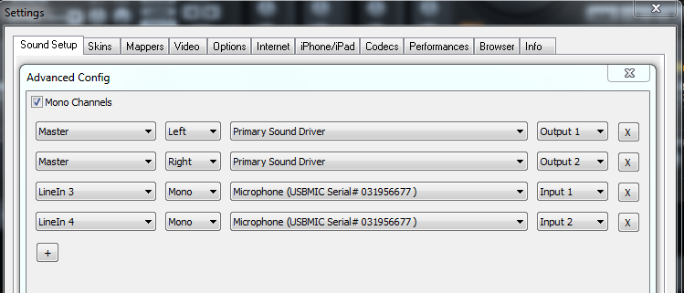

What i want to do is wire my 2 radio mics back into virtualdj. The hardware isnt really an issue as ive already connected via 2 usb soundcards via line in and even also an old PS2 SingStar adapter(Which installs on the PC as a stereo mic, seperate left and right)
The goal is to route the 2 signals to a deck, three and four, so i can apply effects. I have already found on the 4 deck default skin an AUX button, but i haven't got as far as running both mics at the same time.
Do i need any extra syntax in the skin file to connect a second AUX ??
In advanced audio config i can route the mics to the decks..

okay, my curiosity is satisfied..
got this all back out again and did this..
The device in this test is the PS2 singstar. BUT between mic and my headphones there is nearly 1 second of lag.
