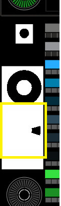

Hey guys I'm using a DDJ-SX and wanted to know is there anyway to change the position of the onscreen jog wheel when a track is loaded. Right now if I load a song the VDJ wheel starts at 9 o'clock while my DDJ-SX Jog display reads 12 o'clock. Is there any way to get them in sync.

Its skin related, and how the author of the skin has positioned the Rotation Marker
It is something that can eb changed within the bmp file of the skin

How would I go about doing that, what excatly do I need to look for and change?

Which skin do you use ?

I use your DDJ SX skin and what a great skin it is I might add.

Open the bmp file of the skin with a Graphics software (Photoshop, PhotoPaint, or what ever you use..even Paint may do the job)
You will have to rotate the yellow part 90 degrees anti-clockwise. (for both Battle and Full files)
It wont be easy though, as you need to be quite accurate and find the exact center point of the sector circle, but the full circle above may help you to align that again.

Well thats not what I expected, but I'll give it a try. Thanks I really appreciate the help and once again great skin
