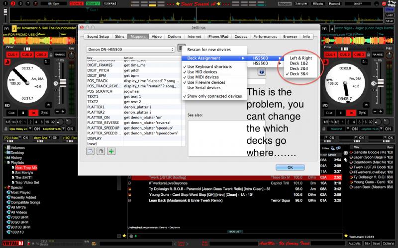

Please look at my picture and youll see whats wrong,
It should say on player 1 decks 1 & 3 and on the other decks 2 & 4 and as far as I know theres no way to change that setting.
Until I can assign which player gets which decks it wont ever work right..........BUT I do have control over all 4 decks there just not assigned the right way.
Sooooooo if anyone has ANY ideas on how to change that id be very, very happy.
Aha, I see the light! As can be seen from what you quoted earlier, I was happy with 1&2 and 3&4.
You want 1&3 and 2&4. I'm pretty sure I never had that option either.
Is the option usually available for four decks?
Posted Wed 08 Jan 14 @ 6:22 am
I would say yes when it comes to the sound cards but for these players I believe its hardcoded in. I have my Quad set as 1 & 3 and then 2 & 4 and I also have my time codes setup the same way. I think this really boils down to the way they were designed, Im no hardware expert though, lol!
