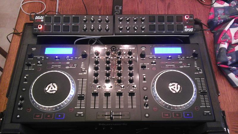

This is why I want something similar in shape and design,
Thanks to Synth and a few others here I've turned this unit into a straight beast! I like to call it my "DDJSX KILLER".

Haha, thats way above my pay grade, lol! I dont know Im thinking Ill just stick with them until something else comes out. So Ill just keep having to check where Im at, after a while it should just become second nature.
Thanks for the time and info and if something does come along feel free to post it up and Ill do the same.
