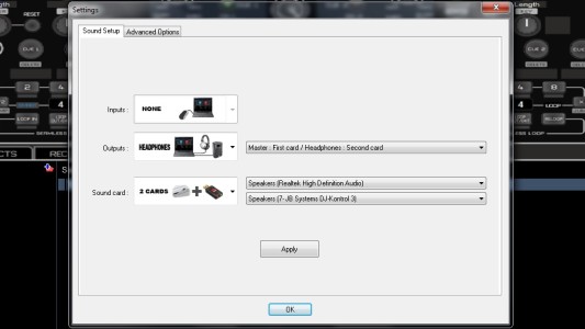

H LE version exei Sound configuration ? Ki an nai, poio einai auto ?
Frontise i karta ixou pou xrisimopoiei to VirtualDJ na MHN einai i default karta ixou twn windows.

Το μονο configuration ειναι αυτο:
