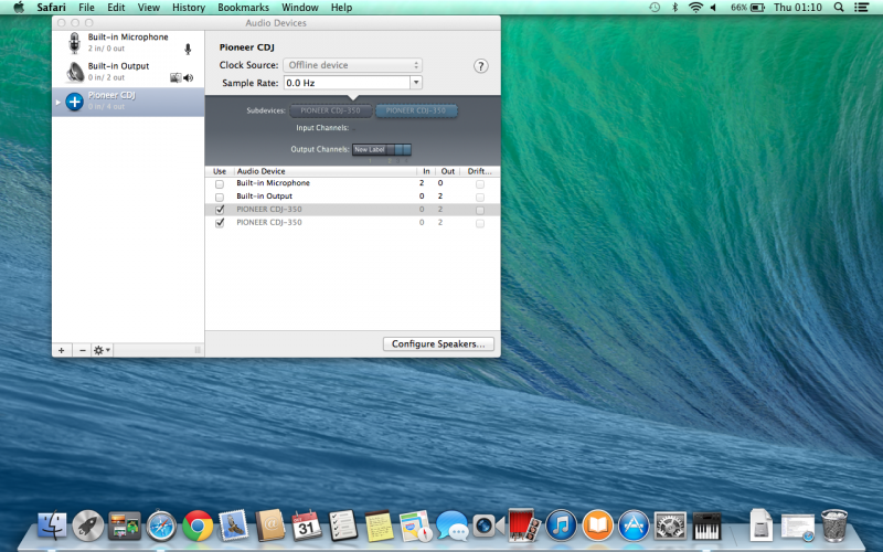

I recently bought a macbook 13.5 to start using my CDJ350's as a controller instead of using CD's. It all set up and works fine but after a while VDJ stops working. I cant access folders on the hard drive in the interface and cant open the config menu. My config is

Why do you have LineIns in the Inputs ?
Can you post a screenshot of the aggregate device from Audio Midi Setup ?

Hi many thanks for your reply,
A screenshot of the aggregator is above.

The pic above kinda shows that the devices are offline.. No Sample Rate is chosen ?? (KHz)
