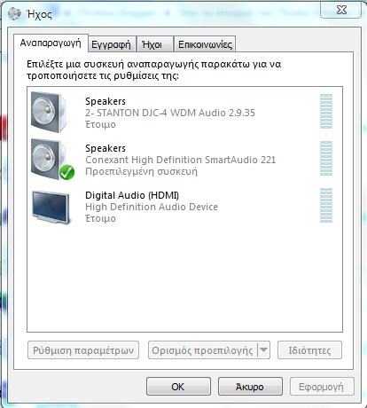

\\\"\\\"If you are using a MIDI controller that has a built-in sound card or you are using an external DJ sound card (E.g: Numark DJIO), then Windows may also be trying to use it as its default playback device, which in some cases may cause a conflict. Make sure that Windows is set to use your computer\\\'s own built-in sound card as its default device (Start -> Control Panel -> Sound -> Manage audio devices\\\"\\\"
Με βα ση τα παραπανω ποια απ τις δυο ρυθμισεις ειναι η σωστη?
Posted Sat 26 Oct 13 @ 8:00 am
H prwti rythmisi einai i swsti, an kai otan xrisimopoieitai to ASIO, oi WDM drivers den xrisimopoiountai, entoutois kalou kakou.. kane tin prwti rythmisi (dld min exeis tin Stanton proepilegmeni karta ixou)
