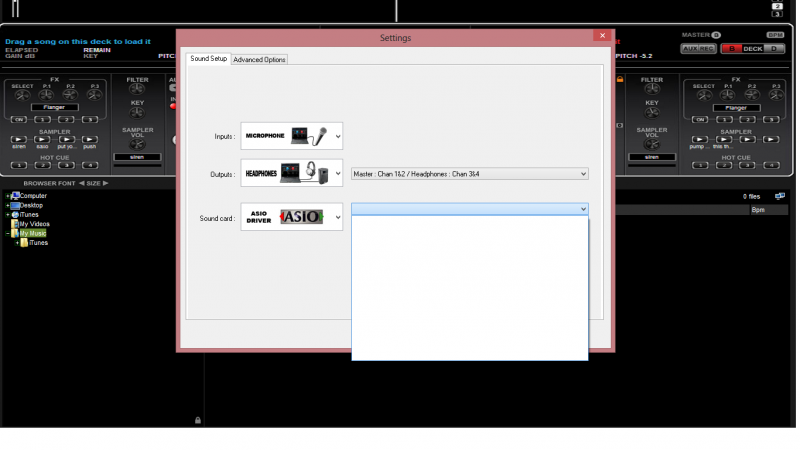

hey guys i was wondering if you can help i am running asio and apperently when i run the mic i am getting echo interferance from my sound and when i try to talk on mic its like running off of my deck i don't want to get more hardware at the moment and just useing my pc as of right now how can i fix this issue if you any suggestions i would like to hear it helps alot i am running just a hp sound card normal one while running asio for my internal mic. helps alot if this issue is fixed soon.

First of all, if you're just running a normal HP internal sound card then you're not "running ASIO".
ASIO drivers are only supplied with professional level audio interfaces and are specific to only that device.
The echo you're hearing is due to latency, which is a delay between the input and output. The standard built in soundcards on computers such as HP are only designed for domestic/consumer use, and so delays caused by latency are common.
To obtain lower latency you need to use a professional audio interface which is ASIO compatible (not ASIO4ALL).

He's not using an ASIO compatible soundcard, just the one in his HP computer. As I explained, this is not (and never will be) an ASIO card.
Mr Demonic Being........there are no free "asio programs". There are only ASIO soundcards (you don't have one) which are supplied with their own drivers. Other drivers will not work.

You'll need to be a bit more specific.
Are you using an ASIO audio interface or controller? Which one? Have you installed the driver? Was it working OK previously, or has it never worked? Give us as much info as possible.

hi
i have the pioneer ddj ergo it was working on my old laptop but when i got a new one with windows 8 and not it dosnt work
