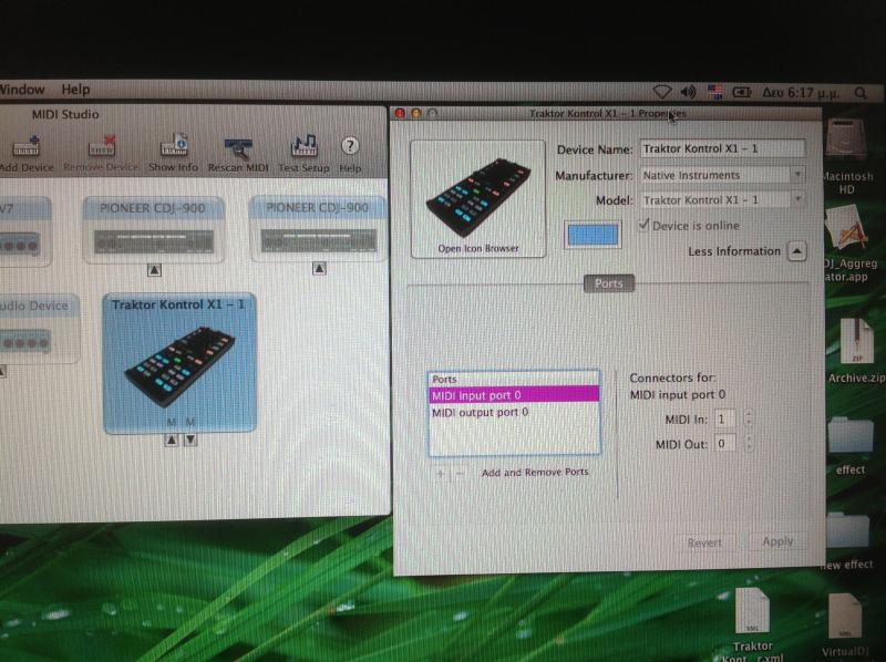

1.
- Me tin X1 syndedemeni sto USB, pigaine sto Applications-->Utlities-->Audio Midi Setup.
- Sto menu sto panw meros tis othonis sou, epelekse Window--->Show Midi Window
- Sto parathyro pou tha emfanistei tha deis tin X1 me kapoio onoma . Grapse edw to AKRIVES onoma pou vlepeis
- Kane diplo klik panw sti syskeui kai tha sou anoiksei kapoio epipleon parathryro. Des an to onoma tis syskeuis einai diaforetiko gia ta In kai Out Midi ports. Grafta edw an einai diaforetika. Scrrenshots tha voithousan episis an den eisai sigouros ;)

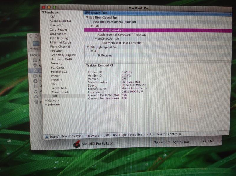

2.
- Pigaine sto Applications-->Utilities-->system Information
- Sto aristero "dentro" kane klik sto Hardware-->USB
- Sto deksi-panw meros, kane ena klik panw stin Kontrol X1.
- Sto katw meros tha deis merikes plirofories. Xreiazomaste to Product ID kai to Vendor ID. Logika tha prepei na einai vid="0x17CC" pid="0x2305". alla thelw na vevaiwthw
1.
2.
