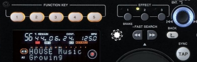

I can you be a bit more specific on what I need todo sorry, all that I have is the old plugin
for the controller which Jpbogsis did for denon hc4500
the setting which he had I am unsure how could you get similar funtions on the new update version of VDJ
The only thing I can think of what I want to require is :
normally on the looping you would you the function Key:
Button 1 - 1/2 beat
Button 2 - 1 beats
Button 3 - 2 beats
Button 4 - 4 beats
Button 5 - 8 Beats
I have worked that function key bit out but its the 'PARAMETER KNOB - (Blue light around it) I cant work out,
normally on the old mapper you can use it to fluctuate between 32 beats -> 24 beats -> 16 beats etc... just by turning it and pressing it on/off when you like. You can still use the fucntion keys swell but you have the option with the parameter knob to adjust what loop size you require
Button 1 - 1/2 beat
Button 2 - 1 beats
Button 3 - 2 beats
Button 4 - 4 beats
Button 5 - 8 Beats
Thanks

something like this should do the trick, it may start on 16 or 32 beats, but once you go lower than that it will never go above 8 beats. It's the same with anything lower than half a beat but in reverse. Also you may need to change 0% to 50% if it doesn't work.
param_smaller 0% ? loop_select 0.5 ? nothing : loop_half : loop_select 8 ? nothing : loop_double
