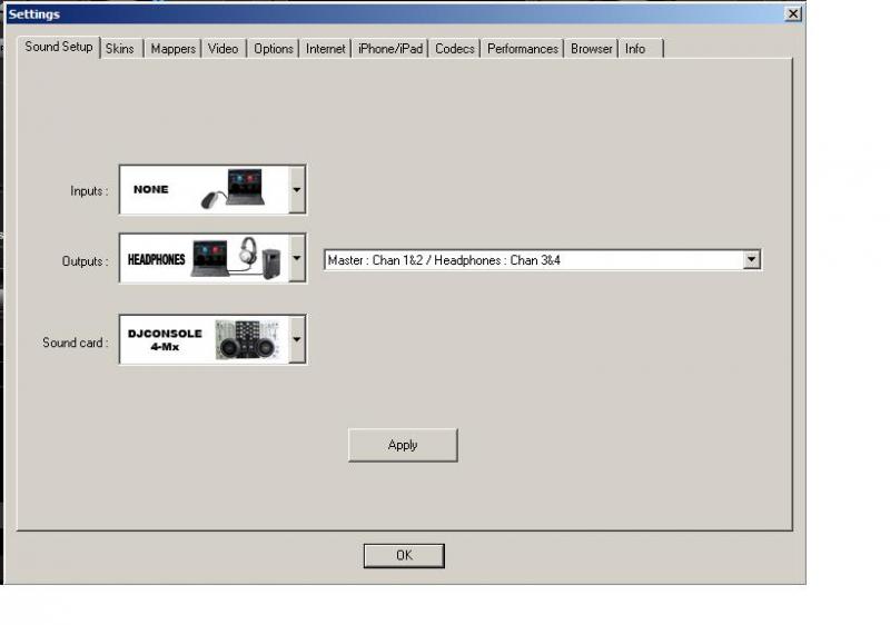

Well don't know how I can get this done, I have a Hercules 4-Mix sound card controller, but when I fire it up using VDJ it switches to ASIO drivers and having my M-Audio mixer already running with Ableton through it's own AISIO drivers, this will not work, any suggestions?
I'd like to use the 4-Mix controller so I'll have main outs which I could route from the output side of my controller using 2/ 1/4' TS wired connector from the main outputs into my mixer channels 7/8 and record everything separately on its own channels, plus have the headphones and midi control of the software, but how can I do this?
Posted Wed 11 Sep 13 @ 5:10 pm

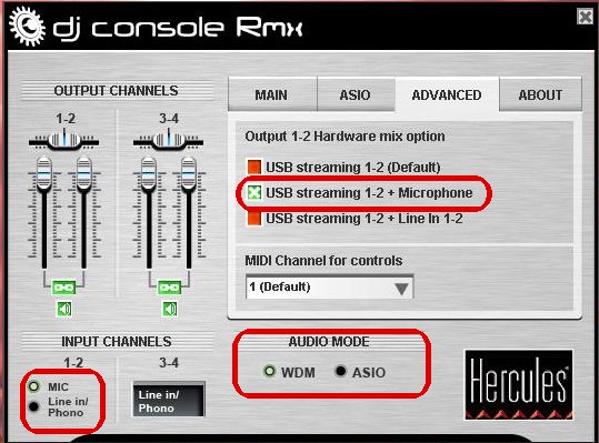

Yes, open up the Herculese control panel. There should be an option to run in WDM mode. Click on it.
Posted Wed 11 Sep 13 @ 5:28 pm

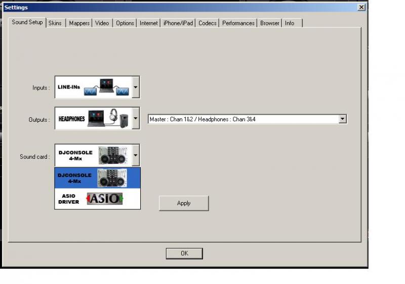

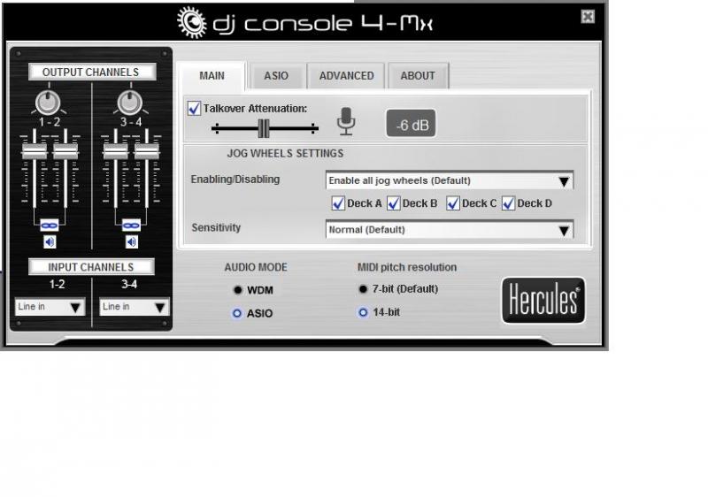

When I configure the 4-Mix as seen in image the control panel in Hercules automatically switches from WDM to ASIO, I also tried the Mic setting in place of "Line 1&2" and got the same results?
Posted Wed 11 Sep 13 @ 6:17 pm
Okay, I managed to get the Hercules control panel to stay on WDM sound drivers when using VDJ, I found this to work using these setting on VDJ and Hercules control Panel, would like to use my lines on the controller, but this seems to flip the panel into ASIO...
Posted Wed 11 Sep 13 @ 6:49 pm
